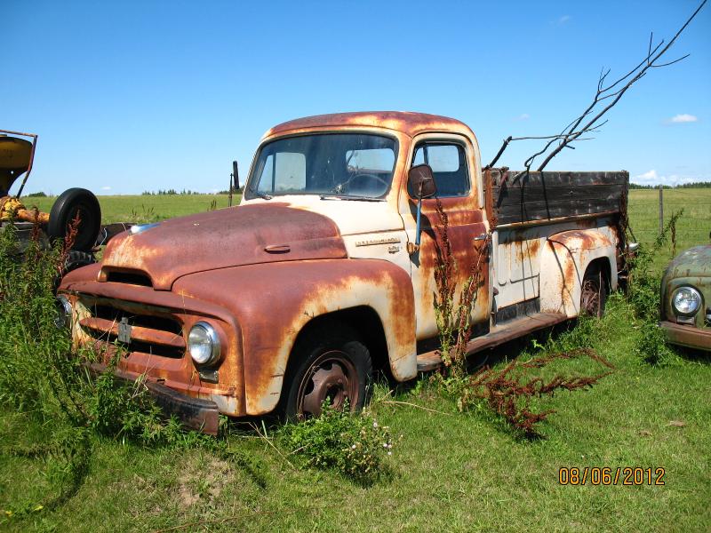

I know it's been a while since I was on this thread and things aren't going according to plans. The original engine from the r130 is completely toast so I'm going with a diesel in it. Over the past couple of days I have removed the front clip, drums, backing plates and everything associated with the brakes. I have started making bracing for the disc brakes and will be doing a how to thread in case anyone else is interested. My conversion is using a corvette manual master cylinder located in the original place on the frame, Ford explorer front rotors, calipers, l110 hubs, and when I locate it, an older explorer (or 9" Ford) rear end

I do realize that life happens when you are making plans. But I was certainly hoping to keep this old truck original aside from rear gearing and brakes. I would have rather kept the 17" rims it came with as well. I love the look of them however the weight is just a bit much and the brake parts for repairing the rear end are pretty much made of unobtainium. If you are lucky enough to find a pair of decent drums, the price will set you back to take out a mortgage on your house and Your first born :yikes: I have located a gmc 6.5 with transmission for $600.00 that runs and I might be able to swing the whole truck for a grand (the guy wants it for crushing after I remove the engine). At least I will have an engine that redlines about the same as the original 6 :icon_4laugh: so I will definitely be in need of better gearing, after all 7.39:1 is a bit too low for a daily driver :crazy: especially at a redline of 3800 rpm:nonod:

Yes the 7.3 is an International engine and this will mean my truck is a true 'binder :winky: I will also be able to lose the 7.39 gear set and improve on the brakes as well. So over all it will be a win - win deal.:smilewinkgrin:
I drove the f350 home today and must admit I'm not overly impressed with the sounds coming up from the tranny, or the way the box is set up on the unit. I'm thinking about losing the box and retaining the one off my '53. I'm also concerned with the braking system and hydraulic clutch, mainly because I don't want to get rid of the original pedals (I like them coming up from the floor) and I really don't want to put the ugly brake booster and mc on the firewall.
