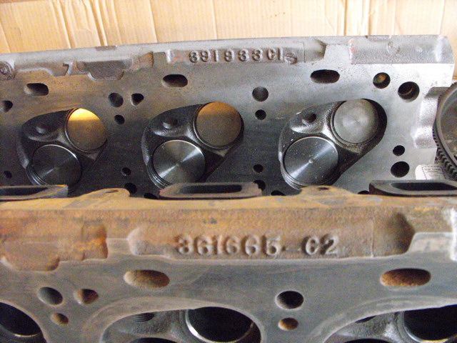

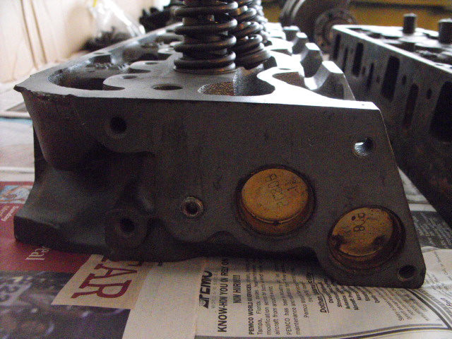

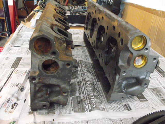

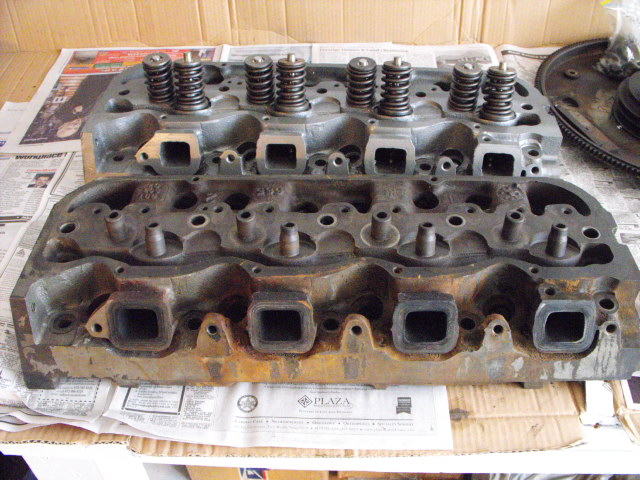

Here are some photo's of the two different castings. As you can see , they appear identical.

On any IH I-4 or sv head, if it was originally installed on an engine (either 152/196/266/304/345/or 392) that was originally equipped with air injection (emissions system component), then each exhaust port/runner is machined for the installation of an air distribution rail system. That would be a hole which is threaded 1/2"x20tpi and May or May not have a tubular "insert" down inside the port.
This tapped hole is right in the center/top of the exhaust port protrusion on the head where the exhaust manifold mates. The rail system used a "gland nut (swivel nut)" to retain each air tube in the port and was a one-piece unit that included a one-way check valve for the air hose connection point.
In many cases (including all my stuff), the a.I.r. System has been removed during engine modification. The resulting port in the head is simply plugged, I use a 1/2"x20 tpi internal wrenching cup point set screw for that, coated with anti-seize.
In this pic, look just to the right of each spark plug location and you will see the hex plug installed in each exhaust runner for I.d.
If your heads do not have the air injection ports...then that is a good thing! I have three similar 152/304 heads here now, none are a.I.r. Heads.

The heads look the same to me -- at least neither has air injection "ports" to my "eye" (brain?).
All I "see" are the threaded holes to "mount" the exhaust manifolds.....:gringrin:
That's why I asked for verification Robert! I can't see the a.I.r. Ports either.
However, let's not confuse this "emissions" vs. "non-emissions" stuff for these motors. That terminology means different things through the evolution of the IH engine product, depending upon which platform it was installed in originally, what the gvwr for the oem install was, what market the vehicle was ordered for, and the engine serial number "cut" point. This stuff was not an "all" or "none" deal and there was much crossover of components used, most especially in a "repair" situation!

Reading back through the post, Jeff c's numbers provide a "clue" -- at least to me. One head is listed as "light duty" -- which implies to me that the other head was probably for a medium duty vehicle.
I "eye-balled" the heads some more and there are a couple slight differences.
One picture shows the "end" of the heads -- one has a "passage(?)" blocked by a hex key screw / plug (like you blocked the a.I.r. Ports with) -- next to the "inside" freeze plug. I have no idea what "this" means....
The other difference (picture showing the casting / part numbers) is that the oval holes below casting number seem a little bit larger on one head -- the medium duty one? But, it could just be the perspective of the picture.

That 1/8"npt "plug" you describe threads into the oil drainback passage on any I-4/sv cylinder head. See this thread for a description:

As for the "ovality" of the hole ya see in the pic, that is a perspective thing! But many times I see various heads where machined or threaded holes used for various accessory mounts on different applications have been scruud over with broken bolts, plugged with jb weld, had stuff welded on!, etc. Again typical "po virus" stuff!

reading back through the post, Jeff c's numbers provide a "clue" -- at least to me. One head is listed as "light duty" -- which implies to me that the other head was probably for a medium duty vehicle.

The plug came installed along with the core plugs on each end from the remanufacturer. All plugs,bolts, valves etc were removed from the other casting to prep for rebuilding/cleanup and inspection. The plug/hole is only on one end of both heads. Is this still interchagable left/right? I guess if you needed it you could plumb a line to it on either end. But since I don't it shouldn't be a problem. All the mounting brackets should still line up, right?

the good thing, as michael stated, is that neither head has the a.I.r ports. So I see no reason they couldn't be matched as long as they have been machined the same (or not machined at all) to keep the compression ratio the same on both heads.
The ovals are the same (camera illusion) I measured them just to be sure.

The heads all interchange, passenger side to driver side, etc.
There must be a plug in any oil return port on the ends of the heads along with the core plugs of course. Those oil return ports are not used in any application other than an engine equipped with an oem air compressor for the brake system. So that rules out any Scout/light line vehicle application.
So...in the case of any head, installed on any light duty engine that port will be plugged!
