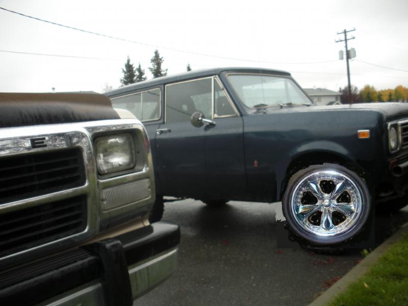

Is it the springs, shocks, and/or tires that makes the Scout ride rough? On my '73 Scout I have, stock springs, four inch shackles front and rear and rancho 5000 series shocks. I am able to feel every little bump or hole on our fine California streets and roads. Does anyone have suggestions on smoothing out the ride on my ride?

Tires, yes, the load rating on mime are c. Had new rims installed three months ago, and did not ask about the air pressure they set. I checked the pressure and found them at 55#. Lowered to 30#, what a difference. Since I don't drive the Scout on the freeways, or above 60 miles per hour for long distances, this should be fine.
