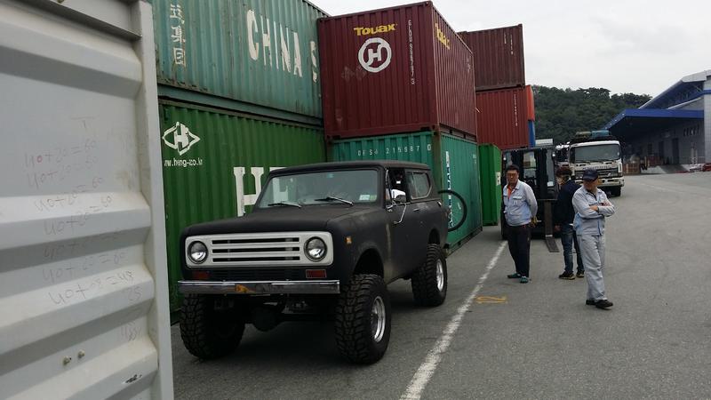

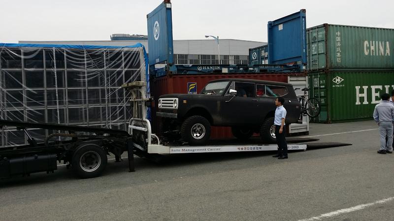

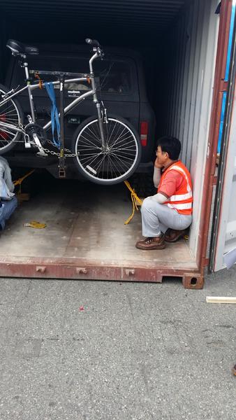

So here are some photos. Got quite a crowd at the trans ship place when the container was opened. My customs agent told me that he could find no record of a Scout ever being registered in korea. Doesn't rule out military as they don't register their vehicles with korean dmv. Bill usn took in Scout to italy for example.

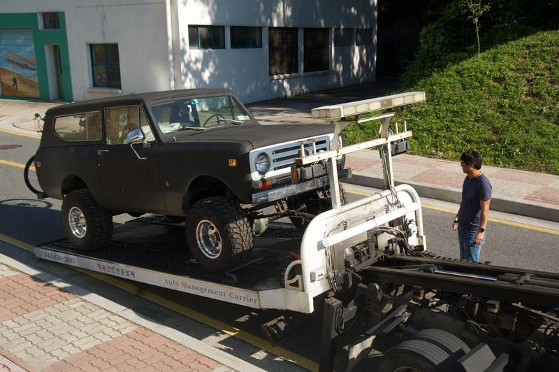

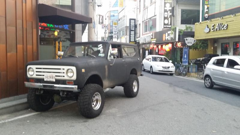

Lastly, on the street in daejeon!!
