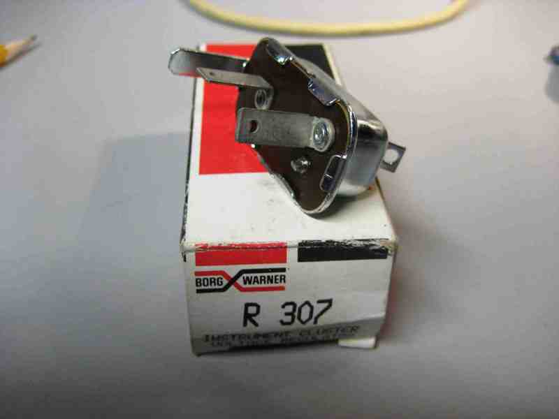

Hey guys,
uhm, another great po move for my 73 s2. Not cvr at all. Just holes where one once stood.
No wonder the gauges weren't working!!:mad2:
I'm hoping there's some folks out there smarter than me that can help me define a couple of things. I'm going to design a power supply for the gauges that can support power to the gauges and also offer a charger/power supply for usb powered devices. I'd also like to make something that is short circuit robust and able to handle the rigors of automotive "dirty" 12v. It appears as though the cvr is somewhat fragile.

I'm no expert, but just went through my collection of cvr's to find a good one. On a analog multi-meter the bad ones would pulse maybe 3-6 times per second or less. The only good one I found read a steady 4.3v. The gauges all read in the normal level with this cvr installed, but normal reads just above 3/4 on the fuel gauge on a full tank which is better than most IH's I've ever seen.
So a power supply that makes a steady 5vdc would probably be just about right. The gauges are just heating a bi-metal spring so they will not be picky about how clean the power supply is.
Thanks fdchappie. I appreciate you checking this out. Not having one limits my ability to test one.
I assume you were testing these disconnected without a load?
Also, I though they were supposed to pulse. :confused5:
Well all dc power supplies pulse to one degree or another. An analog meter will tend to smooth things out a bit. I had 4 here to test and only found 1 good one. And yes that was 4.3v unloaded.
