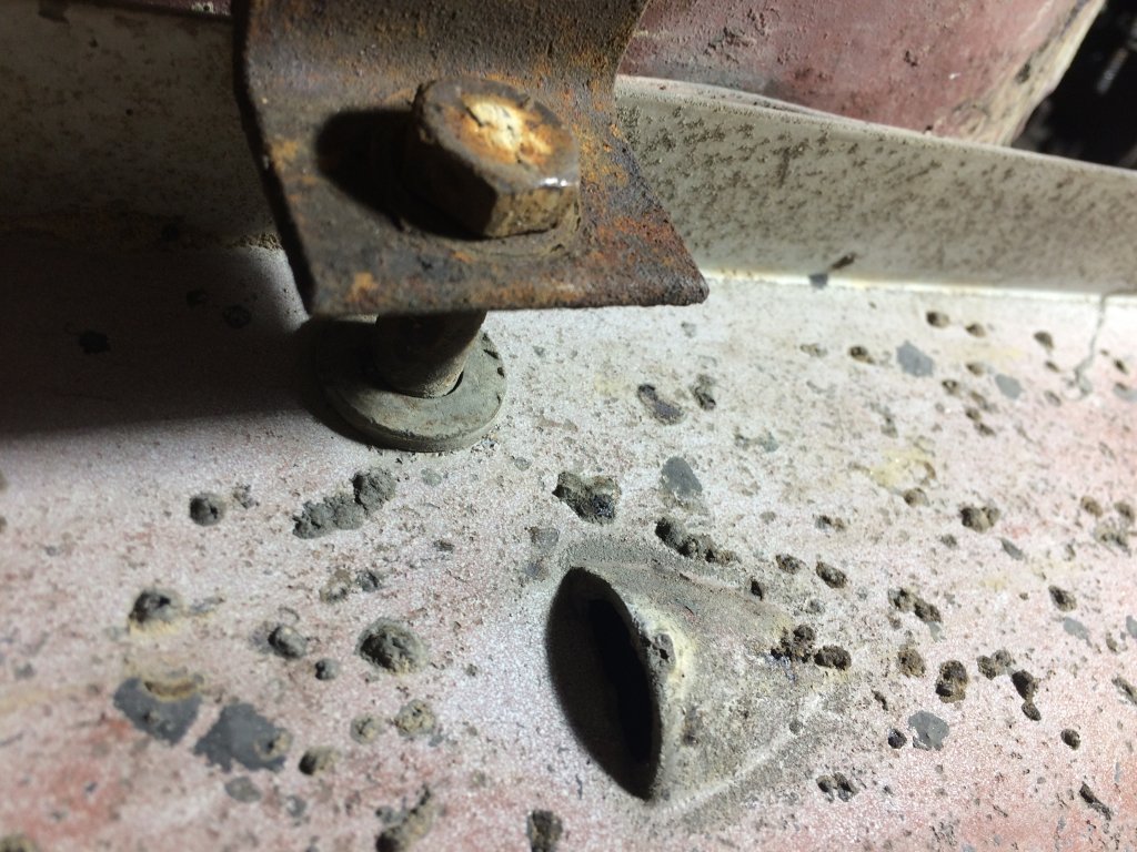

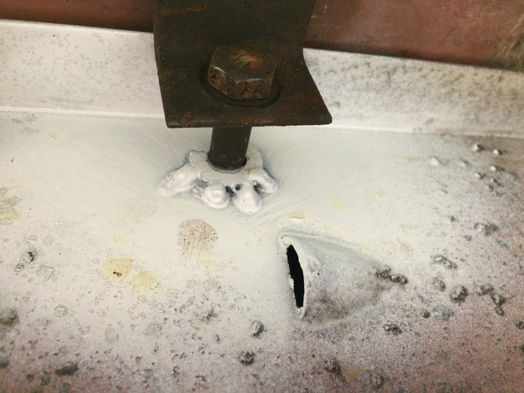

Sorry I missed this. Hope you got it figured out. 68 1200C Travelette I had the nut inserts spin so I tacked them to the metal around them photo attached.

I thought about tacking in some bolts over the hole locations. Didn't wanna do it if there was a way to get to the other side.
Looks like I'll be doing a bit of welding after I either get a new tank or find a way to repair mine. It's shot all the way around
If you can remove the old insert and bolt stub, weld a flanged nut in its place.
