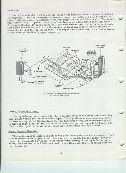

Installing a new poly fuel tank on a 79 Scout with smog/emissions. Scout didn't come with a tank as it was rusted out and running off of an auxiliary tank in the bed. Can someone tell me where all the hoses go? I've got 3 outlets on the top edge, one coming from the sending unit, and 2 outlets on the top corners that I'm assuming are overflows?? Any help would be appreciated.
I also have a plastic/pvc white line that has brake stamped on it that runs front to rear but is not connected to anything at the rear.....
I found that a good amount of it referred to s80 and aftermarket setups and I was really looking to find our where each tank line plugs into and what its function was.
This picture straight out of the factory service manual shows where all the lines go.
