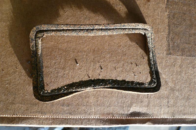

I have been having some odd carburetor. The symptoms were like it was running out of fuel. Mainly she was hard to start after sitting for a week or more. Once running it was just ok but after driving for a while and going through a moderate right hand it would try to stall as if running out of fuel and a quick choke application and off again it would clear up for 10 minutes or so.
It had a chronic tendency to ping/clatter upon application of more than 1/2 throttle after driving on the highway for any length of time.
So I added a semipermanent fuel pressure gauge that I could view while driving. It was perfect, 4 pounds no matter if it was running crappy or not.
So I yanked the old mixer off and pulled the bowl . Below is what I found. The cork bowl gasket was swelled up like a fat tick and disintegrating, shedding pieces of cork... The problem ended up being that the gasket being a little out of position and swelled created float interference. The float would hang up. This would not allow the float to fall and the bowl was thus drained due to a shut inlet valve.
I installed a new gasket and figured the new gasket would eventually swell also so the see through glass visi-flow bowl is on so I can monitor the gasket. Looks cool though :icon_biggrin:
now that I think about it I May have made this gasket.... May be a non fuel resistant material. :frown2::prrr:
running fuel level
Compromised gasket

I did two 1904 builds (both Ford apps) in the last two days Robert. Both had the same issue!
But...in both of those cases, the gaskets were homebrew out of plain old cork sheet that looked like bulletin board material (at least they weren't cereal boxes!).
All the "clearances" of the float system in these 19xx mixers are very tight. Same thing can happen if you don't perfectly center the fuel needle seat when tightening the retaining screw with the two different size copper washers in place.
The cork-type gaskets found in some service kits for these carbs are the correct composite material (cork/viton mixture). The typical cork sheet found at the parts house will not hold up to any gasoline (not just e10). I do have the "good" cork sheet here in bulk that I use to cut similar gaskets when I have to, I did one just today for a Holley aa1 that I had no choice but to make several gaskets.
The gasket in your pic does appear to be the composite stuff however, does it have the black "flakes" melded with the cork chunks??
If you are going to make similar gaskets for these mixers, look for some interface solutions n-8094 in 1/8" thickness at the parts house in bulk form. That is the best stuff and is a vegetable fiber/rubber composite, same stuff sued by Holley today on their non-impregnated gaskets such as throttle body-to main body, etc. Rol is the distributor of the interface solutions line of materials.
Do you have the "thin" gasket between the glass bowl retainer ring and the glass itself?? The retainer ring should not bear directly on the glass.
I just came into one glass bowl in perfect condition but I'm missing two of the four screw stabilizers.
The material seemed to have the black rubber binder but I suspect it in not the viton/cork sheet. I replaced the bowl gasket with an oem one from an ihc kit. I didn't realize/remember the gasket was one that I had made till I viewed the photo and saw the cut marks.
Runs like new again. I also tweeked the acelerator link while I was at it so it tipped in more aggressivly. Ain't run this good for a year or so.
