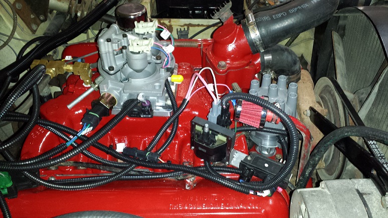

Great kit. And it's geared more for the IH vehicles. I installed one on a friend's 69 scout 800. Pretty straight forward install, following the instructions. At some point, I plan on installing one on my own scout. I don't have any experience with that holly kit so I can't comment on it.

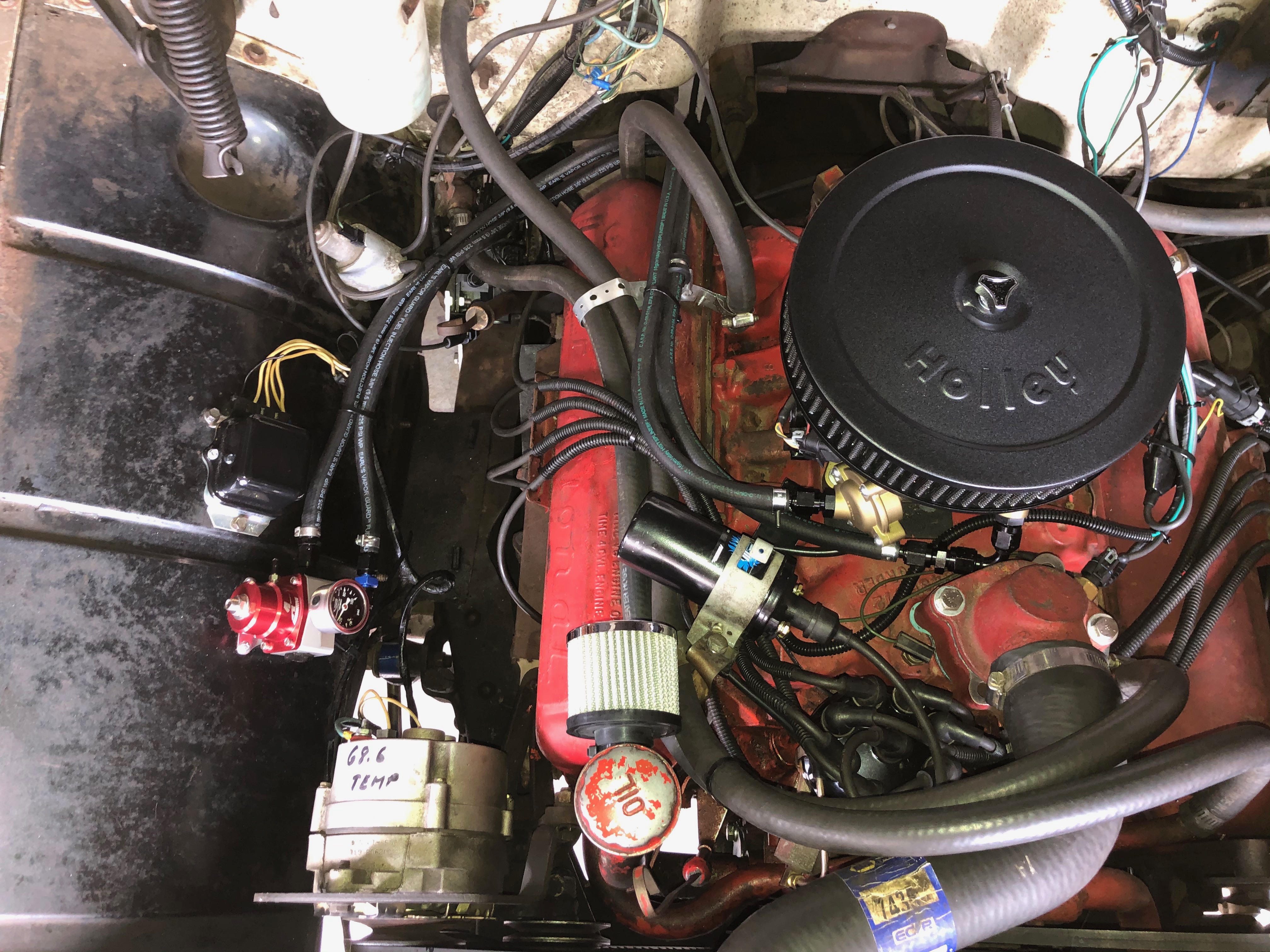

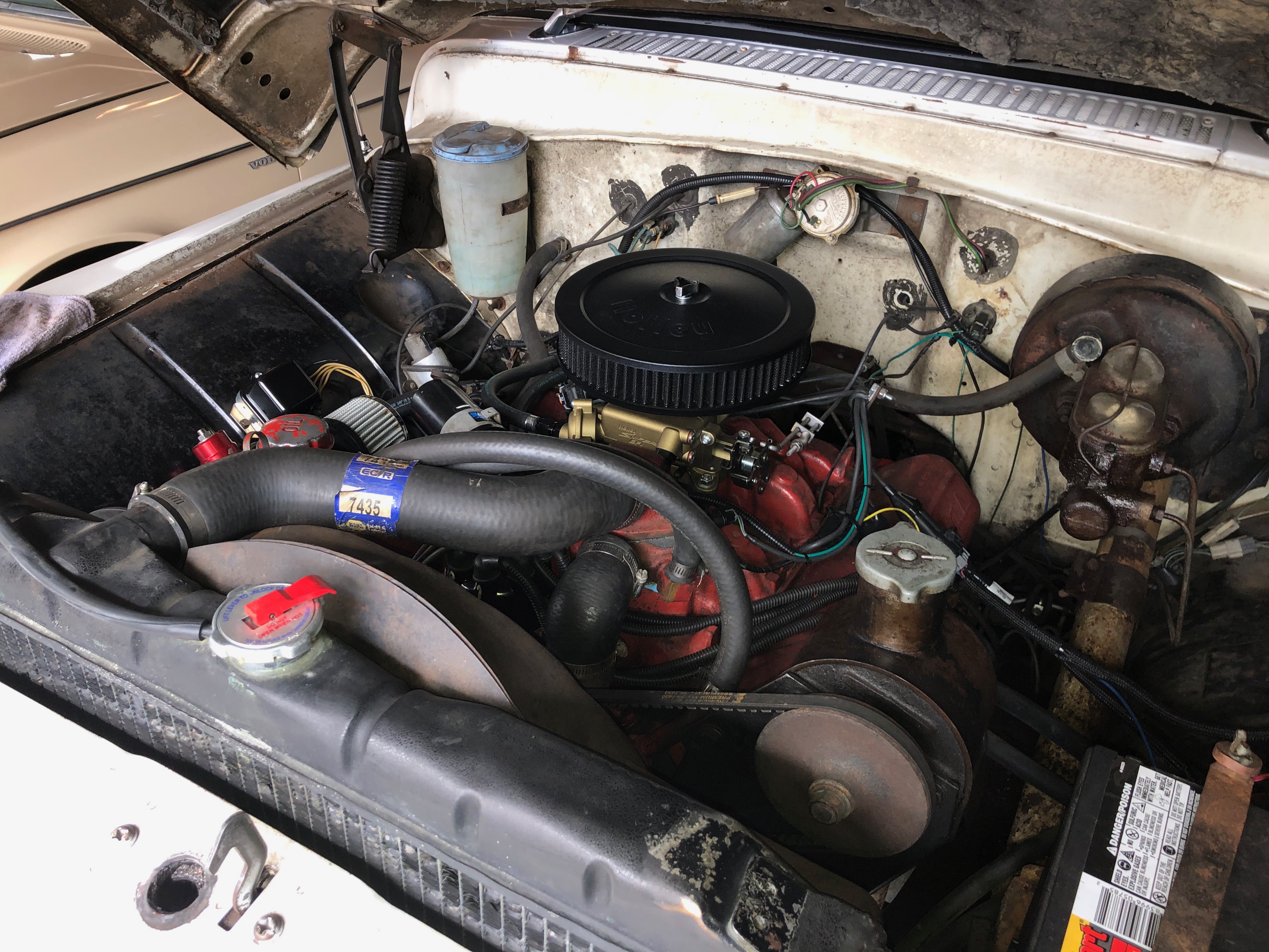

So I decided to go with the Holley Sniper EFI system. Found what i hope turns out to be a good mechanic in my area who runs a speed shop and has been doing EFI systems for many years. trucks been in the shop for about 1 month now while they take their time. Heard it start up yesterday at the shop but its not 100% dialed in yet. I cant wait to hear this thing down the road as its a major upgrade for my truck.
I will end up selling my 2300 Holley which was just rebuilt about 6 months ago. Any clue what I should be asking?

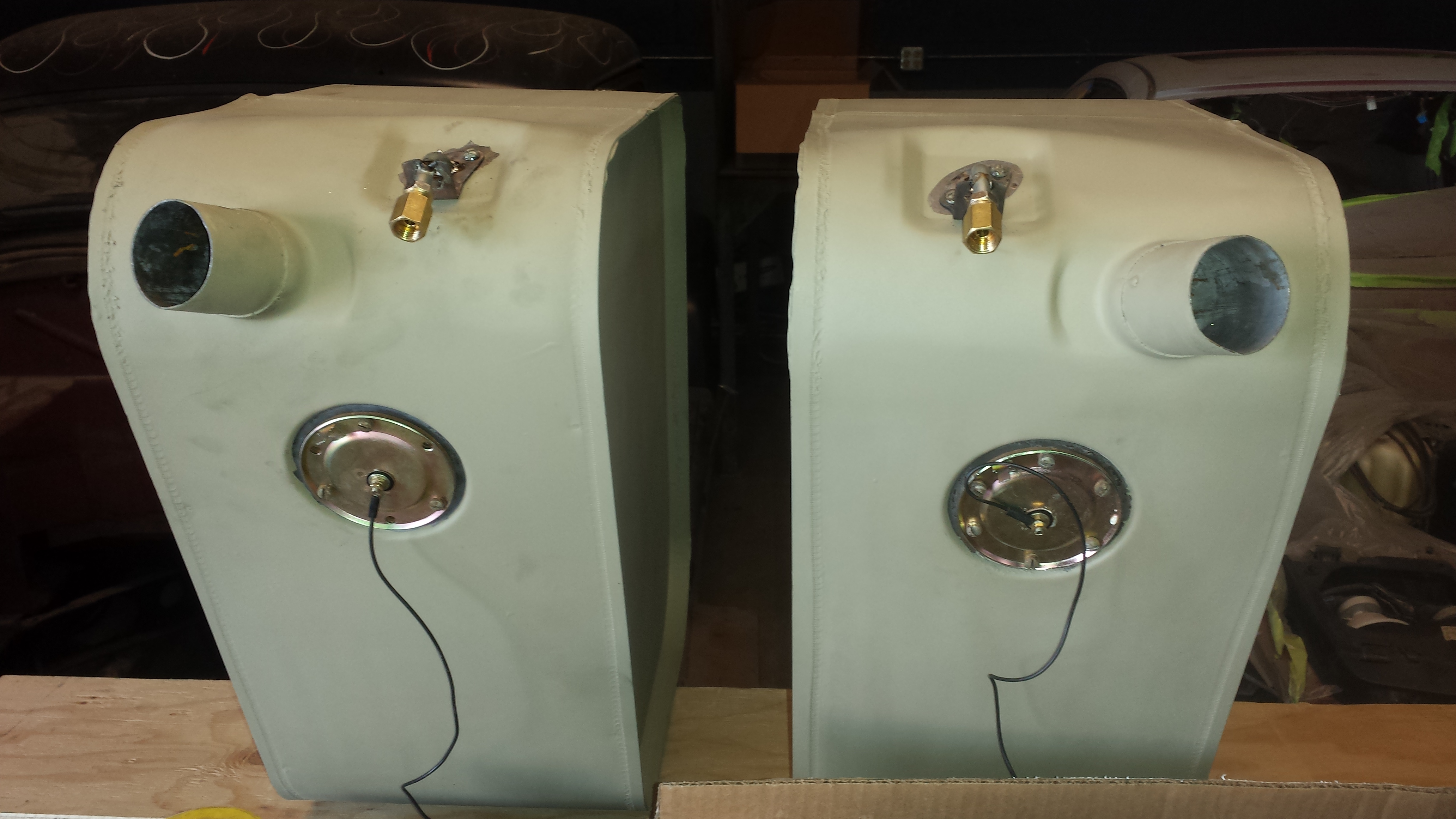

Scooter, on the installation of Hamilton's kit on your freinds 800, did it have dual tanks? How did you plumb the supply and return lines to the tank. I have poly tanks and there is no drain at the bottom to use as a supply line. I'm stumped on installing a supply line in my poly tanks. Any advice will be appreciated. Thanks.

Yes, it had dual tanks. They both were the OEM metal tanks that were in great shape. I modified the original pickup tube to be used as the return line. Then I used the drain hole as a feed line to the motor. I have photos of what I did, somewhere
For the poly tanks, I haven't felt with them to give any definite answers on. One possible way is to modify the plate on top of the tanks that hold the sending unit and or the pickup tube and add another tube into that plate, to be used as a return line. Bill Hamilton, or one of the guys up at IHPA, might have better options.

Found a photo of the tanks after modified. Sorry for my slight misinformation above. Been about 6 or 7 years since I did this. And forgot where and how the sending unit was mounted.
I also found out last October during the fall Rallye, after he did the LS swap, he ended up getting rid of the two saddle tanks and installed one tank between the frame rails under the bed area near the tailgate
As far as adding a second fuel line in the poly tanks, I'm not sure. Best bet is to shoot off a message to the guys up at IHPA or Mr. Hamilton himself on their thoughts

That's on the 69 scout 800 with the OEM 266. That's the Hamilton efi kit. Thing ran great. But since a rebuilding of this motor is unobtainable internal parts, he decided to go with the LS swap.
As far as I know, the IH 345 motors still have internal replacement parts if rebuilding is required. But pricier than the LS motor rebuild

I went with the Holley Sniper EFI 2300. So far my impression is mixed results. Tech support sucks and the people who answer the phone are morons. It needs some tweaking from the guy who installed it. I too have dual tanks and they are properly plumbed in bur I have to still switch manually which tank I want to use.

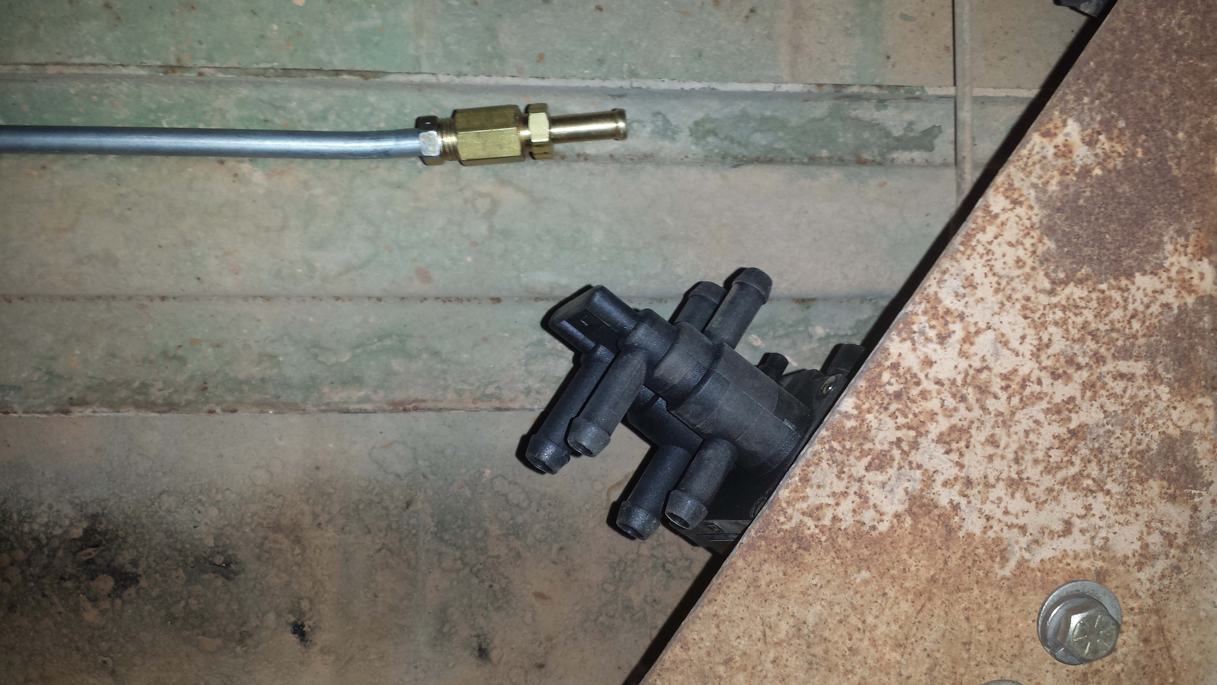

The electronic valve that I installed for the dual tanks in my friends scout 800, is operated by a toggle switch on the dash.
All the fuel lines, feed and return, from both tanks and from the throttle body are hooked up to those ports on the valve. The wiring for both sending units(in each tank), the single fuel gauge, and the toggle switch are all wired into that valve. With this set up, the manual valve was completely eliminated

If anyone out there has installed this sniper 2300 EFI kit, Id love to hear from them about their own experience. I guess my system is rather complicated. I had originally told my install guy to just stick with one tank, and because it was a present turned into dual tanks with 2 systems. I dont know if this is true, but I have to prime the Holley system first by turning the key one click until I hear the pump going. Once stopped after 5-6 seconds I then crank it over. the fuel/air ratio is where I want it however im noticing when i back it out of the garage then onto the street from reverse to drive it stalls out. The AF ratio on the LCD monitor turns yellow then red in the upper 20's. I called Holley and they claim some torque thing and it was putting to much on the engine. I have no idea. I did in crase the idle RPM though from 1000 to 1100 and that seemed to make no difference. Waiting for the weather to get nicer so i can bring to back to the shop. Just hoping I was able to tweak this myself. I noticed they also set the CI on the setup to 401 but my enginer is a 304. I have no idea if that means anything or has any bering on the learning process of the system.
