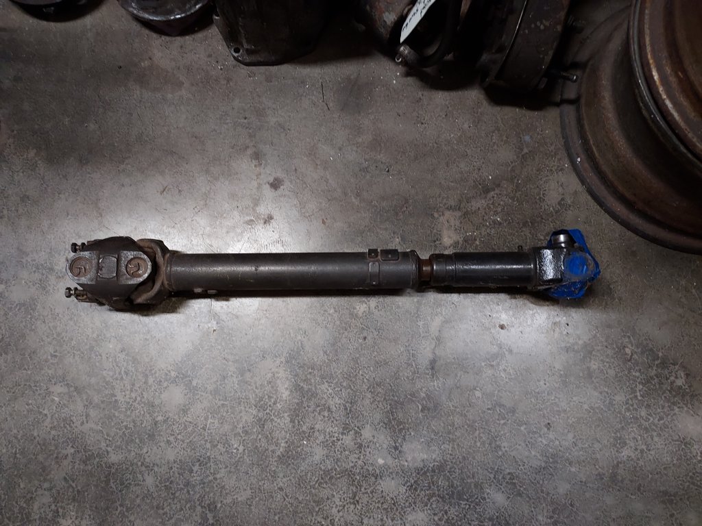

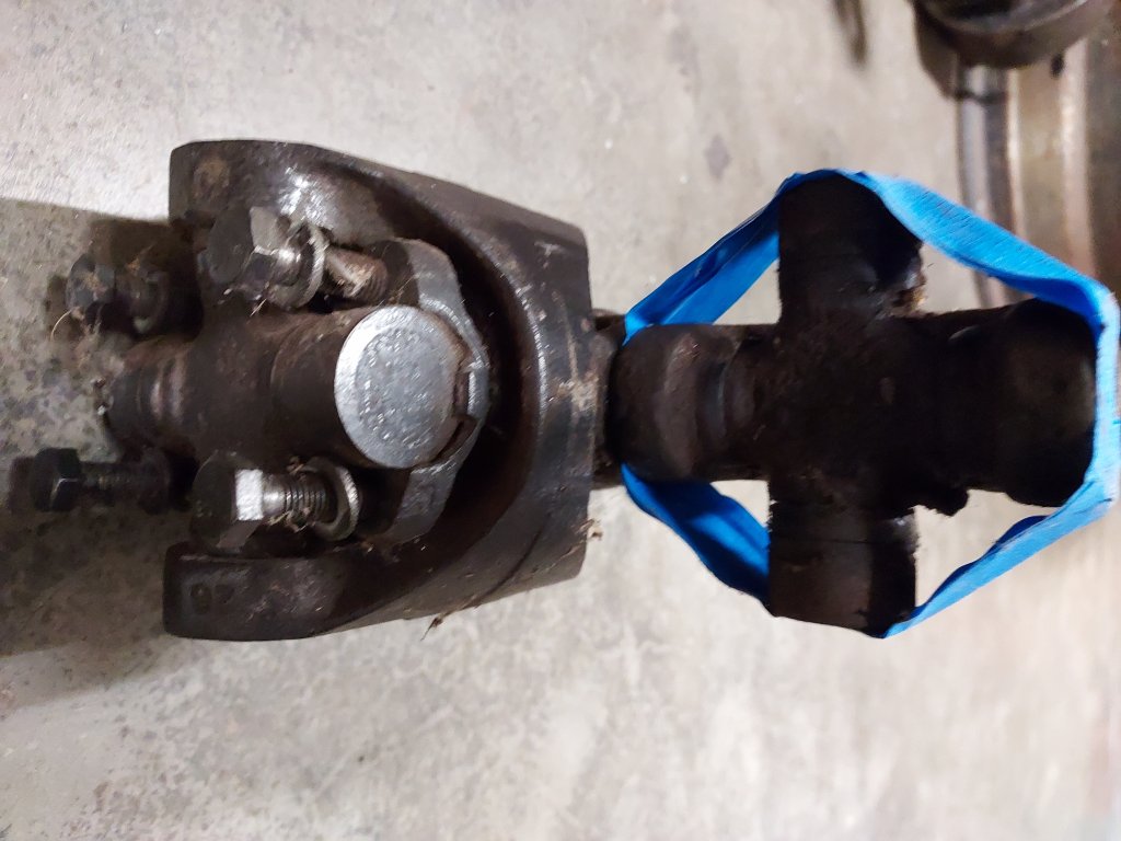

I planned a spring over for years, collected parts, ect. Did the spring over in 2010 using a cebby front axle I cut to Scout width. That said I'm still using the stock front drive shaft and it "kinda works" at speeds up to about 60mph. Anything over that I'm not gonna push it. I found a part that I forgot I had scrounged years ago, a front cv drive shaft.
I "think" it's from a q track heep/early ferd brnco with an auto trans. It has the same u-joints as a Scout, it's about 3 inches too long for the travel I have. I have installed it on the t-case, looks like it will clear my auto trans. The CV is 3 3/4 wide by 4 1/2 long.
Thoughts? it will cost me about 350 to have it rebuilt and shortened to bolt in my Scout

Those pic's I posted, the CV is about 1/4 bigger at best, than the u-joint size, Installed on the t-case yoke it looks like it will work perfect.

You will need the proper short Spicer CV yoke on the tcase. So add another $100 bucks to get one of those. They are pretty simple to rebuild, just buy 3 new u joints and a centering yoke. (Ball and socket). You could probably have adams Driveshafts build you one for $500 all in brand new. 1310 u joint is the correct size for stock shafts.

I have the stock t case yoke, I have modded the bolts to fit and still have the bolt ends to the end of the cv shaft yoke. I have built countless cv shafts over the years(18 years in a trans shop).
I "could" rebuild the shaft regarding the u joints but the only local drive shaft shop here will not change shaft length unless "they" install the parts.

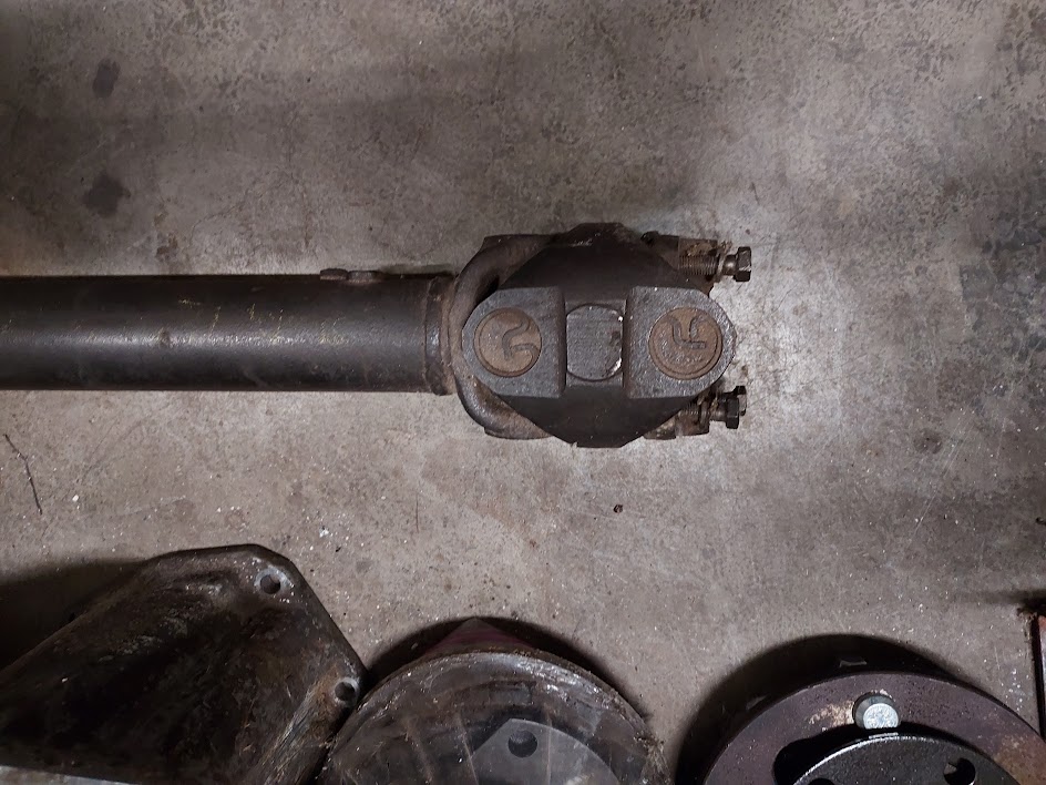

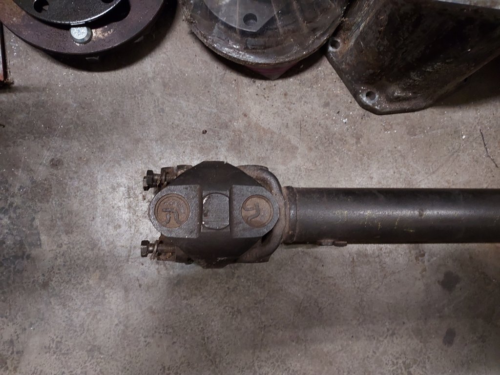

Another pic.

If you haven't tried the CV shaft yet - it's likely to hit on the corner of the 727 at the CV.
And also - like your stock driveshaft might - against the 727 pan edge by the front.
The pictured driveshaft is 1.75" diameter front unit from a 4cyl TJ.
I'm going to see about a smaller diameter version to see if it'll clear the pan better - among other things, the balance weight wants to hit the pan and I can't clearance it *that* match - so my choice is to lower the bump stops by a good bit, or reduce the diameter of the driveshaft.
There is a 1.25" 1310 CV end.
