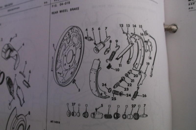

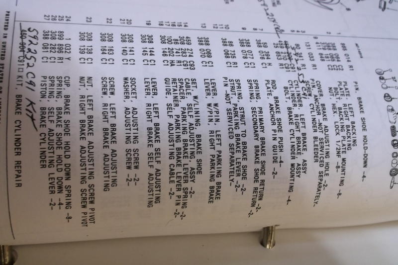

What Scout do you have ? A 80 or a 800 ? I can post pics of the brake assembly for you or email them to you.? Also what rear end do you have ? D-44, tapered ? ( the nut holding the axle on type ? )
Well thank you that would be great. I have a 1978 Scout 2. Try to bleed brakes today and front right and rear left would not blead. I think I'll take everything apart and blow the lines out with compressed air ?
Here ya go ! Hope it helps.if not let me know.
