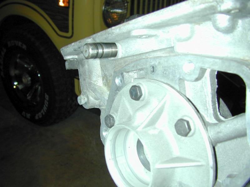

*edit* one more question. I'm a l/r pivot pin o-ring away from having this tranny completely dry. Is there another way to replace that o-ring without removing the tail housing while I'm in here? Can it be pulled out instead of pushed out through the tranny case?

In order to perform the entire low/reverse piston mod, the valve body must be removed. Then the short strut is removed from the actuator arm position in order to allow full travel of the arm for piston removal.
In order for the arm pivot pin to be removed, the output housing must come off. There is a projection on that housing that is holding the pin in place, no way it can come out from the opposite direction.
This pic shows the pivot pin partially removed from the rear. Some rods have two "o" ring grooves but use only a single "o" ring. I buy the "o" rings in bulk and always use two if the rod has two grooves.

What a big project for such a little o-ring! I guess I'll let it be until I can pull the tc for a rebuild. I might as well go ahead and perform the servo mod while I'm in there I guess. I May be posting to this thread if I get stuck!

The pivot pin "o" ring does not "brittle and crack". They simply leak. Replace it with a new"o" ring of the proper dimension and it will be fine. If the shaft has two grooves, then put two "o" rings on the shaft.
The only thing to do to the "o" rings is to lube with trans fluid. Never use anything else and most especially don't even think about applying jbweld anywhere!!!!! There is no need to do stuff like that, these units have been in service more than 50 years with no problems at all!
