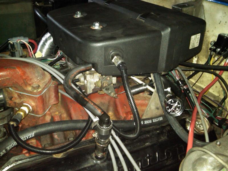

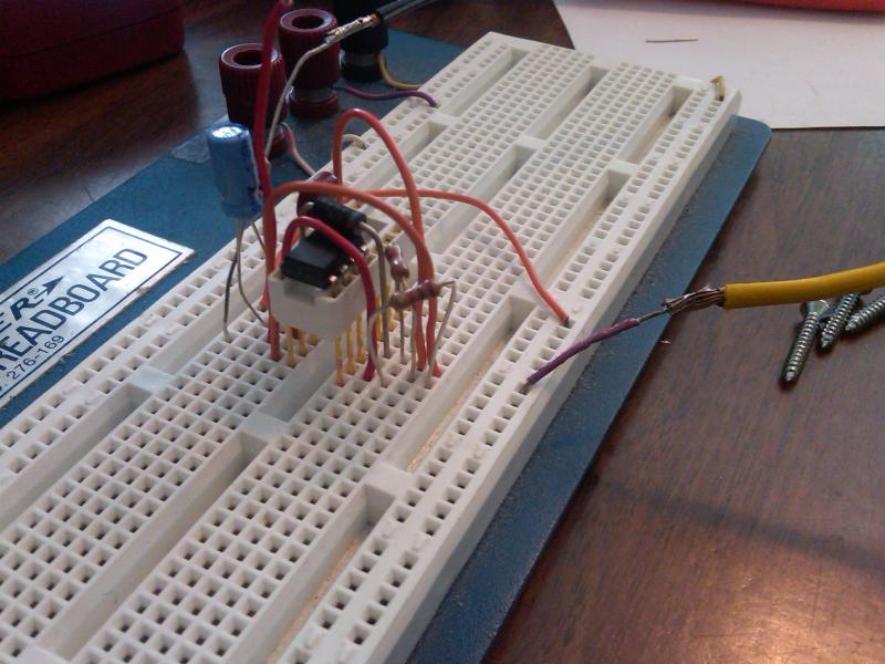

I used a 1228746 ecu off a 1989 camaro (5 liter with manual trans). One of the problems I had was that I didn't acknowledge the vehicle anti-theft system and it's consequences. Due to this my initial cranking was just that (with no ground provided to my injectors). Once I figured that out I purchased a painless vats defeat to send the appropriate signal to the system allowing a ground for the injectors. I actually put together a unit on a bread board that worked fine (all of $5 in parts), but my soldering skills weren't up to the challenge hence the painless unit.

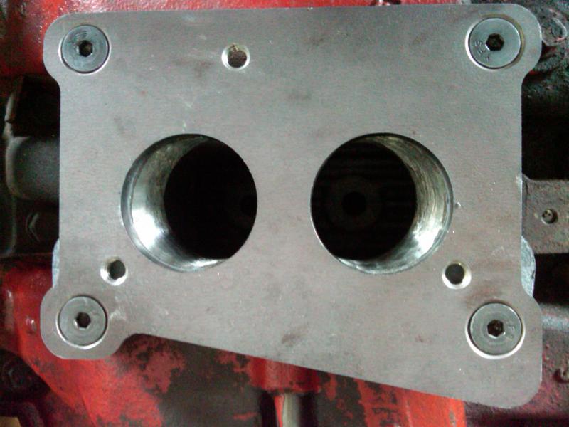

Another thing I did was grind down the intake a bit to smooth the transition to the TBI adapter plate.

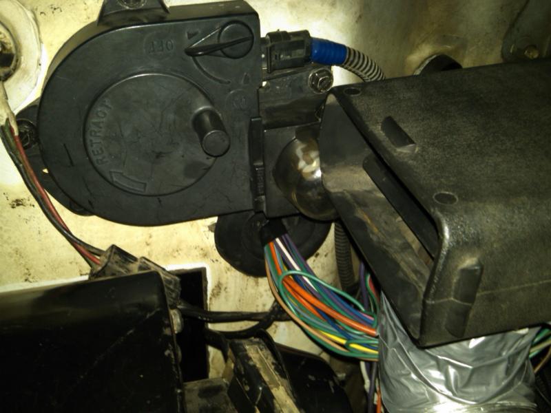

You can also see where I put the harness through the firewall. The grommet I used was a 2 in. I harvested off a '75 Ford pickup. I like this spot because I think I can store the ecu on top of the heater duct. Not sure whether or not it will be too hot there.
The system has the iat, egr, o2, vss, oil pressure switch, and purge canister on the system as well as the other standard sensors.
Before I installed the tb I sent the injectors over to witch hunter for cleaning and testing. I didn't know anything about the condition of those and figured the cost would be worth the certainty it would provide.
