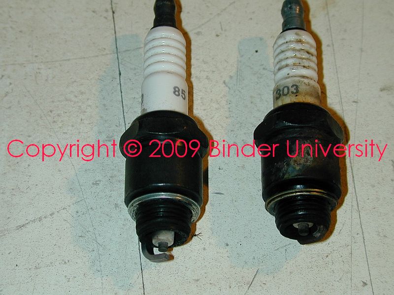

Well I never checked, they were what was in it when I bought it so I assumed they were stock and replaced them. Ill call the auto parts store and see what they recommend.
Autolite 303 plugs are the exact same spark plug heat range/spec as an autolite 85. The difference between the two plugs is the tip design. Either plug callout is suitable/correct for your engine. Don't ever trust some partscounter monkey to make a spark plug recommendation!
An autolite 85 is an "extended" tip design based on plug technology of the late 60's/early 70's. That is a design used for engines that have sufficient plug tip-to-piston/valve clearance to prevent any collision damage. In some cases regarding engines that consume oil due to poor ring and valve stem seal, they tend to "self-clean" a bit better than a conventional tip plug. Also, they worked best in "emissions" engines running very lean mixtures across the board and along with the crappy base ignition timing "spec" that emissions setups demanded. Nowadays we have to throw in this shit e10 fuel which does not want to light off under compression. Talk to your congressman about that clusterfuck.
Comparable champion, ngk, bosch, denso, etc. Plugs are available also in both designs with interchangeable heat range crossover.
