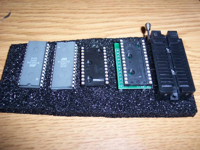

1- g2 memory adapter: 0.6" spacing
$30.00
2- c1 atmel at29c256 chip
$6 ea. = $12.00
1- s2 aries 28-pin zif socket
$10.00 (optional)

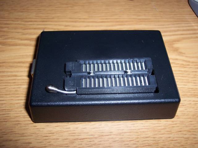

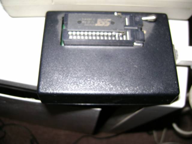

1- burn1 flash-n-burn usb-based chip programmer
$85.00
1- free moates.net sticker with $100 purchase (required)
sub-total: $137.00
g2 memory adapter: 0.6" spacing [model: g2-0.6] $30.00
Product description: allows use of new flash chips in many GM TBI setups. If the original application accepted a 24-pin chip such as a 2732a, then this adapter will allow you to upgrade to new flash chips such as the at29c256 and 27sf512. Soldering required (see product web page). This is the unit which will work if your original application had the chip holder with leg spacing of 0.6". Just check before ordering, you'll need to take the ECM apart to find out. Comes with everything you need to replace your stock chip holder with a standardized 28-pin chip socket that is compatible with the newer flash chips. Installation service available for $25 if you're not comfortable soldering.
C1 atmel at29c256 chip
Product description: this is the most popular chip. Replaces 27c128 and 27c256. Works great in many applications such as honda, GM tpi / 93 lt1 / etc. These are 90ns 28-pin chips, direct replacement for 27c256 chips, can be flash-reprogrammed many times without uv eraser. Can be used in place of 27c128s and 2732as (with g2 adapter) as well, just program them with an offset (start of device = 4000 hex for 27c128 original, 7000 hex for 2732a original).
S2 aries 28-pin zif socket
Product description: very durable 28-pin zif socket. With this socket installed, you'll be able to switch chips in and out of your g1 adapter or other application very quickly and easily! Heavy-duty construction, very good contact with pins. Great for emulation interfacing! For use with 29c256/27c128/27c256/27sf512/27c512 type systems. Package gp1 comes with this socket already. Goes well with a g2 adapter as well. This socket will not clearance some of the honda ecus, so we recommend the low profile s4 for those applications.
Burn1 flash-n-burn usb-based chip programmer [model: burn1] $85.00
Product description: usb chip programmer works with the at29c256, 27sf512, and am29f040 chips. Self-powered from the usb port, so no power adapter is needed! Burner can also be used to read stock GM memcals using the hdr1 adapter. While it will only program the three types of chips listed, please note that those three chips can be used as drop-in replacements for most efi applications. Comes with stand-alone chip programming software (available for download). Also compatible with tunerpro rt. Will read most stock-style chips (2732a, 27c128/256/512/etc).

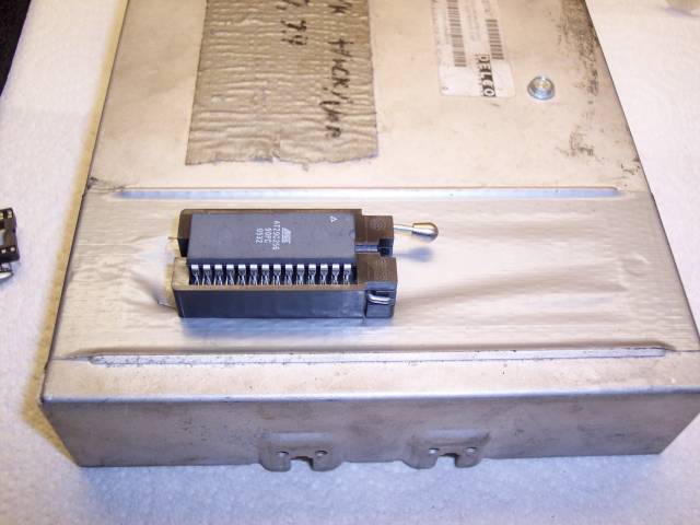

for a third option you can simply replace the 2732 chip with a modified 27sf512 chip. Then you simply use the moates burn one to program it.

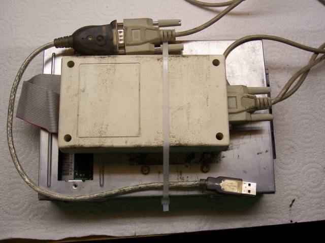

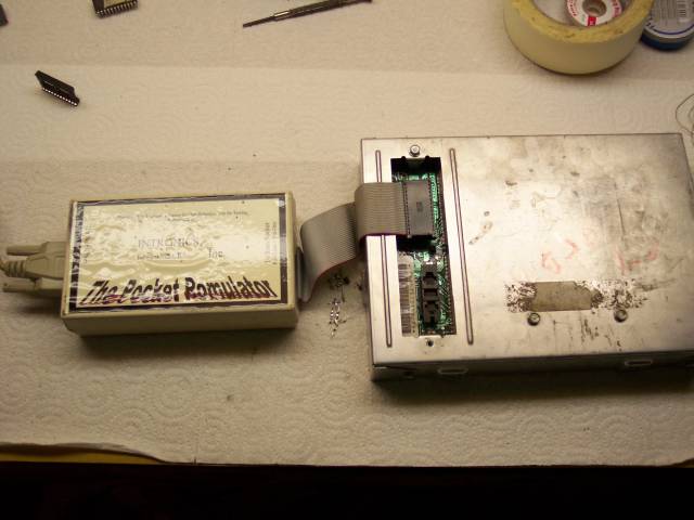

I also run a romulator. This allows real time programming as you drive. Then when done you just download the bin and program it to a chip.

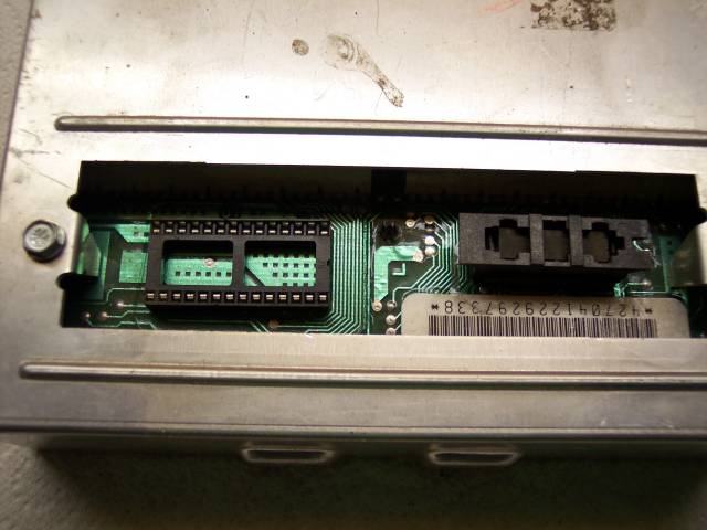

Here is my other modified ECM with a standard 28 pin socket intalled.
This allows you to just r&r the chip with out the holder, or install a zif socket, or plug in a romulator for real time programming!
Moates also sells an all in one unit and it's own emulator.
