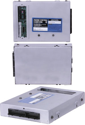

As a secondary you can use the 1228746 computer from the cars but will require an iat sensor and a different chip than the 7747.
If you are pulling the system yourself then pull everything off the motor that the harness is attached to! You can throw the unneeded parts away later.
Basic system:
1. Computer- better known as the ECM-engine control module. 1227747 or 1228746 you will need someone to program a chip for you to optimize the computer to your engine.
If you don't know what engine your computer came from, see the attached file below.
You will need the 3 or 4 letter bcc-broad cast code.

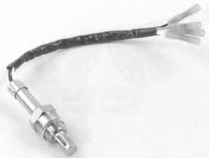

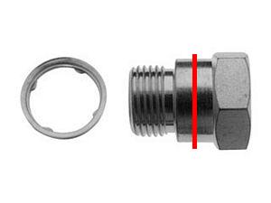

5. O2-oxygen sensor- you could pull from donor but a new one is cheap. 1 wire sensor will work fine. The universals just splice onto the wire from the harness.
For headers I recommend a 3 or 4 wire sensor. They have a built in heater to keep the sensor hot when it is mounted down in the collector.
To mount the o2 sensor you can buy the regular o2 bung or it they are not avail I use the 18mm sparkplug antifouler cut in half.

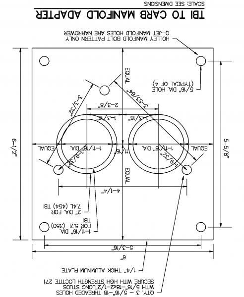

9. Adapter plate for the tb- you can make one (see attachments) or buy one.
Spreadbore 4v- Holley
17-41
transdapt
2206 and 2207
squarebore 4v- Holley 17-45
2 barrel- Holley 17-47
transdapt 2204 and 2205
