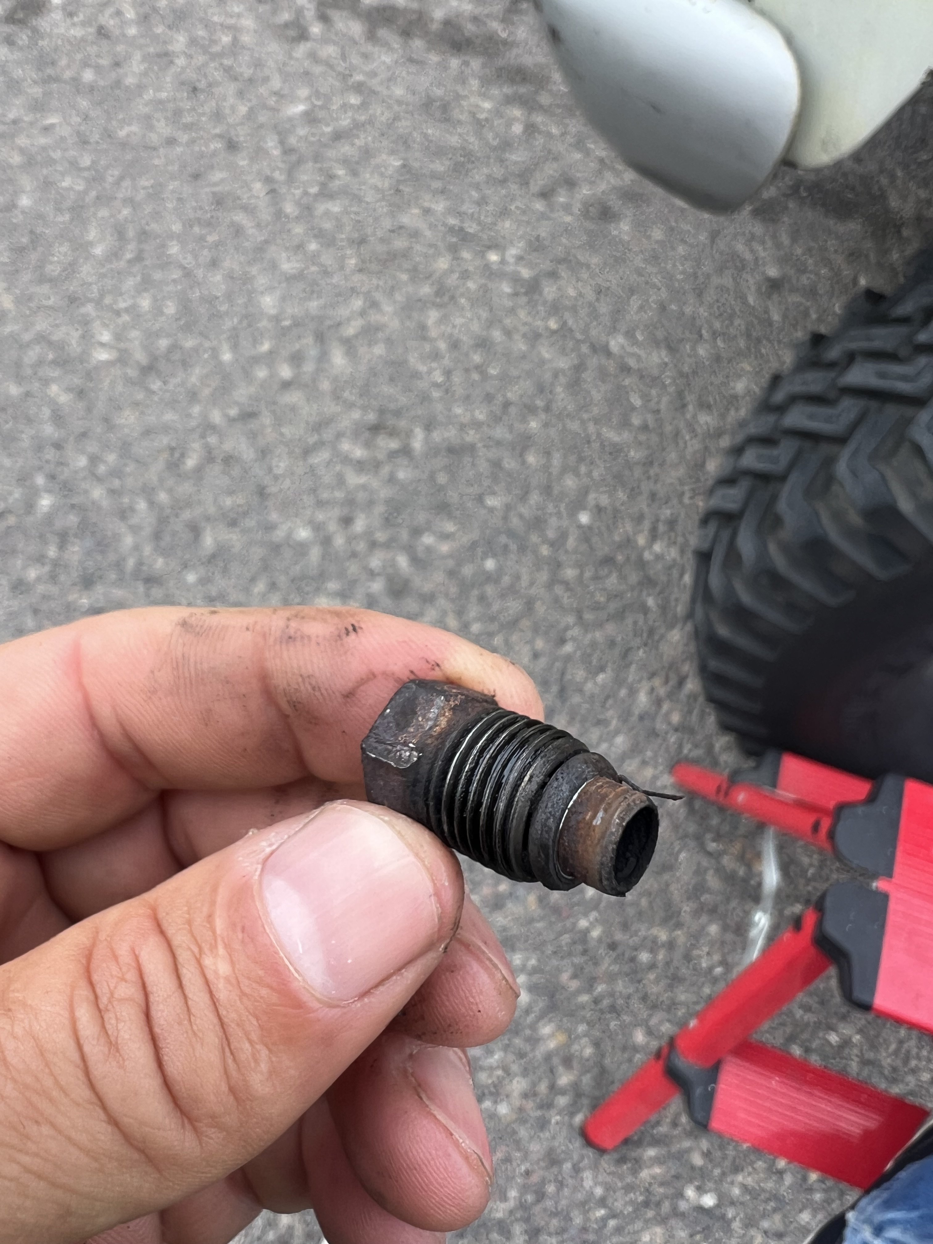

Hello, new here. First time posting. Is this the bolt/plug you’re asking about? I’m missing one as well. Is this part available or can I use a generic bolt? This has a little rubber o-ring at the end of the threads.
That will work, but your likely to get a chirp at certain engine speeds as the exhaust moves over the empty hole where the shoulder was. Don't they still sell those plugs here?

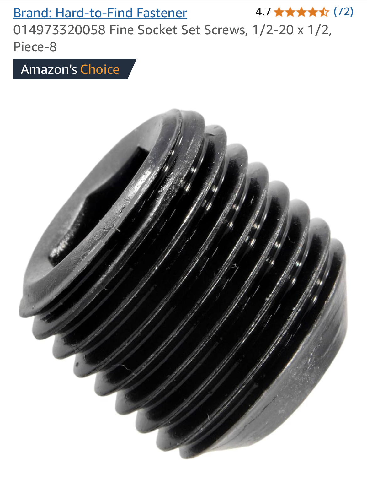

That’s the existing plug in the next cylinder. I can’t find that exact plug. Foimd this on Amazon:
I haven't noticed a chirp but then I haven't been listening for one. The Brass plug fits snug and goes into the manifold a good amount. I'll pay attention and see if I can identify a chirp.
