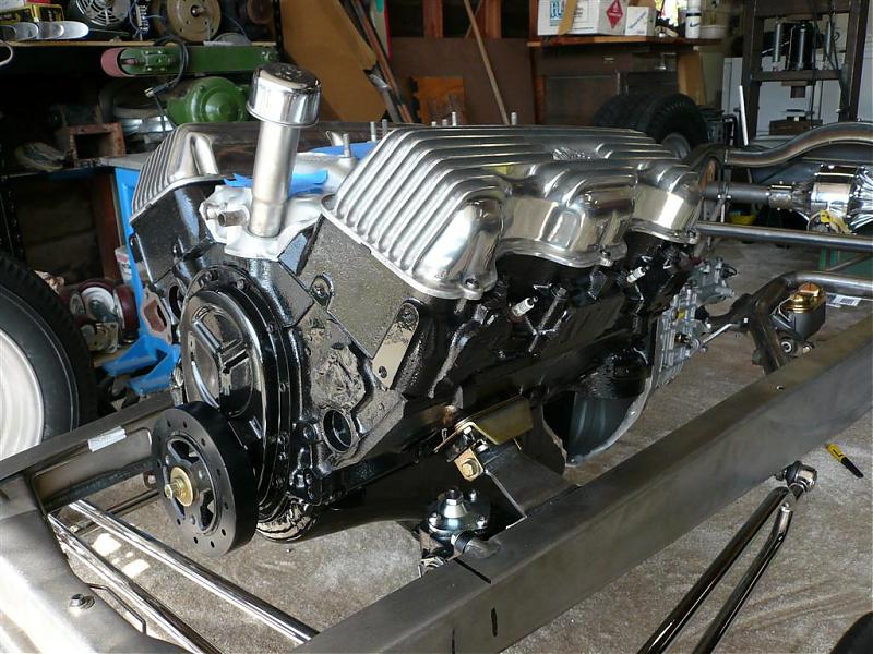

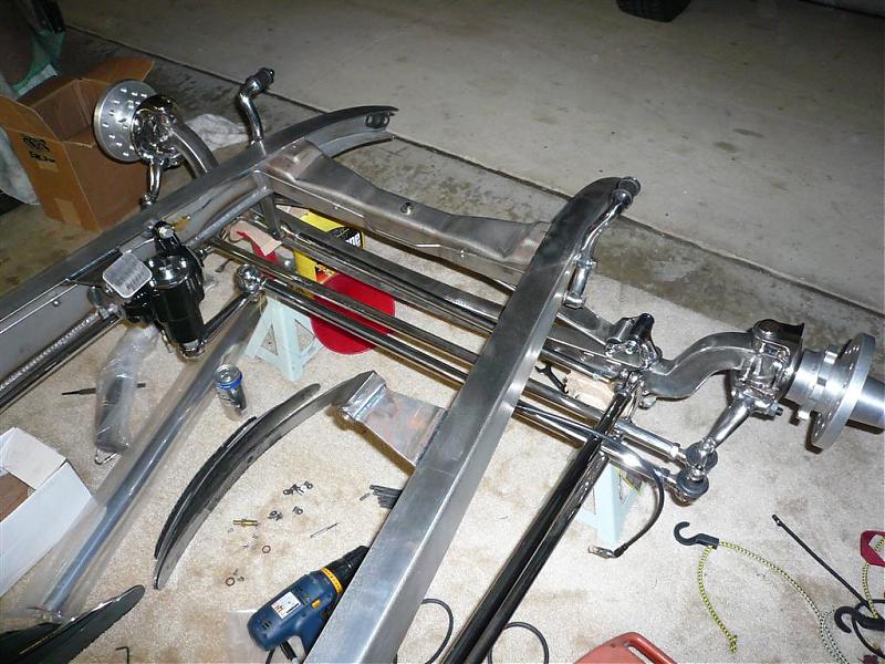

The Chevy engine mount is a very simple one to fabricate. I attached some photos of the standard GM v8 mounts on a 32 Ford frame I built. Note the plate on an angle and the tube below it. That is all that makes the mount specific to a sbc or 409 in the case of the picture. You only need to build the stabd off from the Scout frame rail to the mount end detail. This style of mounting will except any of the truck/passanger car rubber mounts of the style shown used from the 60's to the when the ls generation of small block was introduced. The rubber mounts are availible in two heights. That is not a concern to as you will be building the metal work to fit your application.
The flat plate above the tube is not really necessary but helps during placing the engine in to the car. The tube is the attach point.
You can buy a mount kit but you will have to modify it some to fit the Scout so I always build my own.

I used these when I stuffed a bigblock into the 800, they will work fine for a 327. I did have some gussets on the frame mount. You can also re-drill the mount to offset the engine if you need to.
