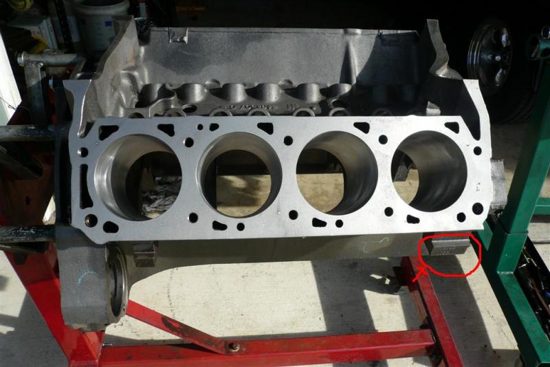

I have been searching for two days and can't find a post on where to locate engine size. Pretty sure its around the fuel pump, but even with my radiator out and a thorough cleaning I still can't find any numbers stamped on anything. Still haven't used a mirror. Anyone??? Suppose to be a non-ic392, and since the whole front end is appart, guess I'm just looking for confirmation....
Thanks
This is the normal location for the stamped engine id.
