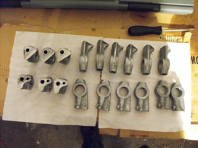

Good work on the rocker stands tonk!
If you have some type of flat surface (such as the deck of the fresh block?), then hold each stand agaianst it and try and "rock" the stands to check for "flatness". The tool marks I see are a good sign, but in looking at hundreds of these stands over the years, many will not show any machine marks.
Also, using a flat surface (piece of nice plate glass?), line 'em all up and use a precision straight edge across the top. The surface where the washer seats was not a precision surface to begin with. But, ya can get an idea if any of the stands have had the bottoms butched using that method. Then slide 'em all onto the bare rocker shaft and repeat the glass test. If they all eyeball as flat and no air gap between the glass, then you are ok. Carefully inspect each one for cracks in the bolt hole area, I have many that are cracked from previous ham-fisted service operations! If they are cracked, they will allow oil bleed. If the tops are kinda grunged from the washer, then ya can carefully surface each with a belt grinder, they don't have to be perfect, but do need to be parallel with the head surface in order to seal.

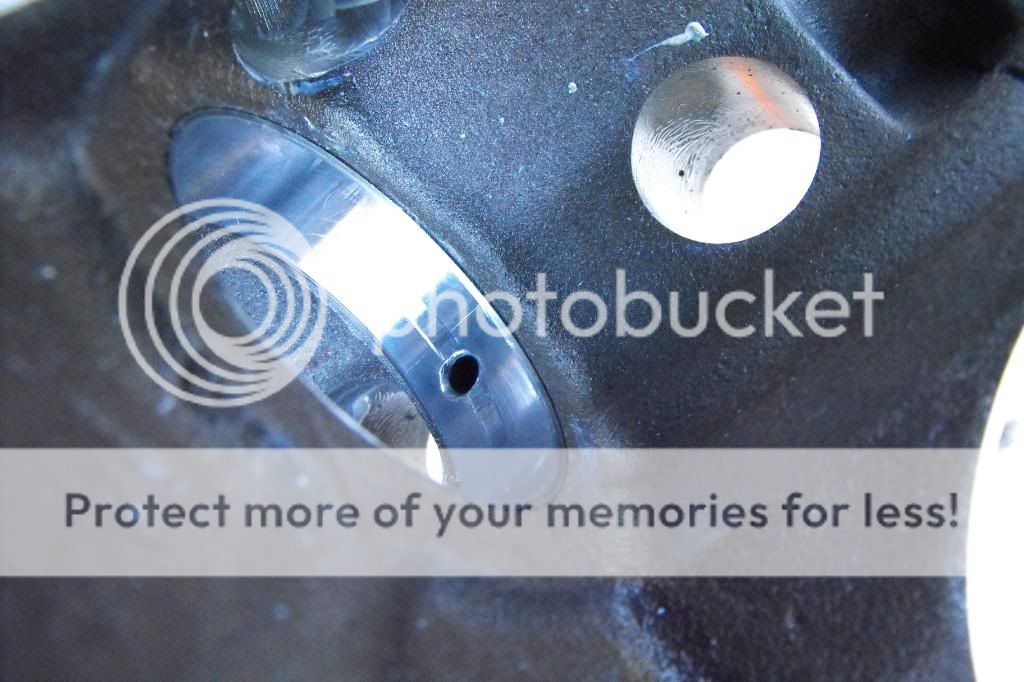

That build up evidence is what has driven me to make sure that the cam bearing spit holes did not restrict or create a place for future deposits to gather and lessen the oil flow to the top end.

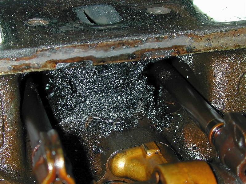

With regard to the picture of the top-end, the carbonaceous material you see there is really, really old oil which has been subjected to more heat, either due to a mechanical problem, such as cooling system, or the oil was just plain low quality. The yellowish-brown deposits you see on / around the pushrods and rockers indicate that the oil has oxidized, in this case, a pretty bad case of it. Once again, this could have been caused from a mechanical problem, but more than likely owner neglect and / or poor quality oil......
Flash points on engine oil as well as base-stock quality can have an awful lot to do with creating the conditions you see in the photo, another factor is volatility. These qualities were not paid as much attention to at the time this iron was made because engine temperatures did not run as hot as they do now, but the other really important factor is not an oil factor, but a human problem...... Lack of good sense when it comes to maintenance.
It is true, without mentioning names, that many of the engine oils on the market would display signs of varnish and sludge way before other brands would, that would mean that the oil had gone further than it's designed useful life, and the protection went downhill fast. Once oil starts oxidizing and the metal wears develop, the nitration count goes up, which in turn also increases the total acid number.....so it is a domino effect. When you see yellow-brown to dark brown deposit stains on the dipstick, it's a sure warning sign that what's under the valve covers and in the engine is a lot worse!

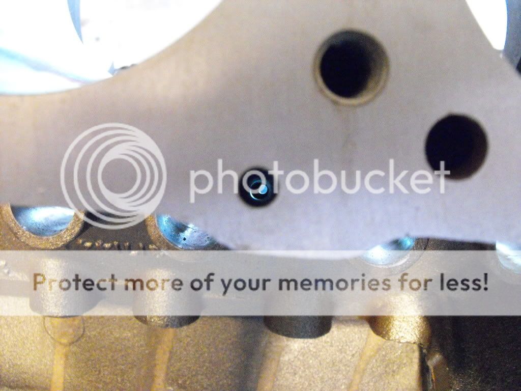

I'll get that Picture later tonight of the half blocked drain hole caused by the stock head gasket.:icon_eek: would be nice to see what the fel_pro guys did, so tonka that will be your job:smilewinkgrin:
Edit... A little grider action on the block would fix this

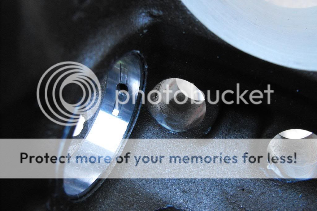

lost this thread for a while:( here are the pic on the rear drain back holes. These are good pic's as they came from freshly dismantled engine.

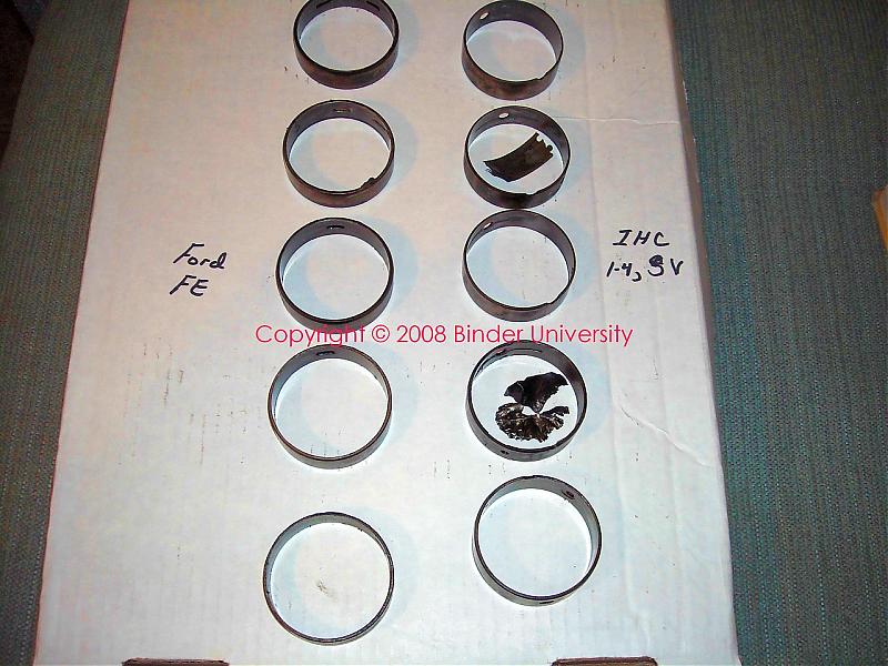

Trying to keep cam bearing-related information confined to this thread, here's a shot from yesterday.
This is comparing a set of Ford fe (390) cam bearings (oem) with a set of ihc sv (oem) cam bearings. These engines are mounted on stands sitting side-by-side and are in the process of being majored.
Both sets were failing/failed while the engines were in operation here at the shop. Failure modes are very similar, with the babbitt layer disappearing and/or delaminating and wadding up and being spit into the sumps.
These bearings are near identical in actual dimension, shell width varies slightly depending upon position. The cam journals for each engine are in usable condition with no damage or measurable wear. The Ford cam is an isky grind onna new blank, the 345 cam is oem.

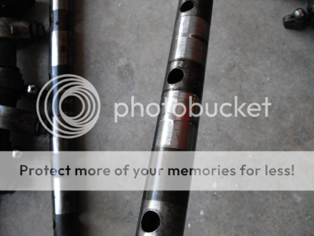

For the record regarding the 345, the rocker shaft feed holes on bearings #2 and #4 measure 0.152". The primary feed supply holes to all five bearings measure .235" and none were aligned perfectly in the block.
Once each block returns from the machine shop, we'll install the replacement cam bearings here for each, and then show the methodology for "blending" the oil passages with the feed holes in the bearings at various positions.
I've verified that there is considerable "offset" between the rocker shaft feed hole in each head, and it's mating hole in the block. The obstructions are not created by the head gaskets, there is ample clearance at those points. This offset will be corrected on the 345.
In addition, the drainback passage on each head is grossly misaligned with the block receptacle, so that will be rectified also. But then, so are the fe passages.
The cam bearing tool being used for these operations is an older version of a lisle #18000.
