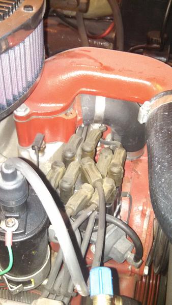

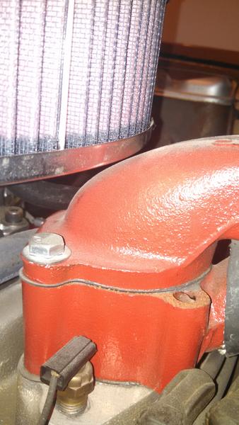

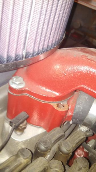

I've got a '77 sii, 345, 727, 1406 carb, 4bbl aluminum manifold and stock ignition system. I think I May encounter a clearance issue with my t-stat since I barely clear my air filter. Need some eyes on this before I even think of ordering. Does it appear as though it'll fit? I've been scouring these board and the bp boards but nothing that shows this tight of clearance to the housing itself.
Wouldn't mind a few eyes and thoughts on this.

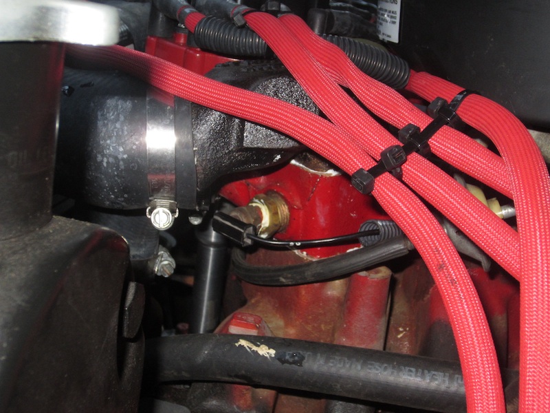

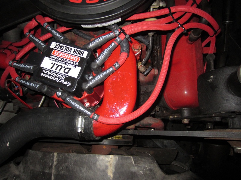

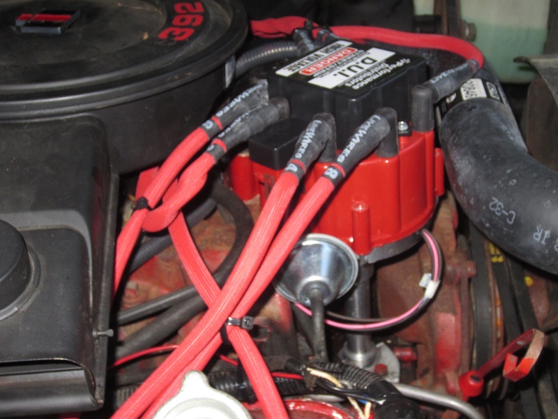

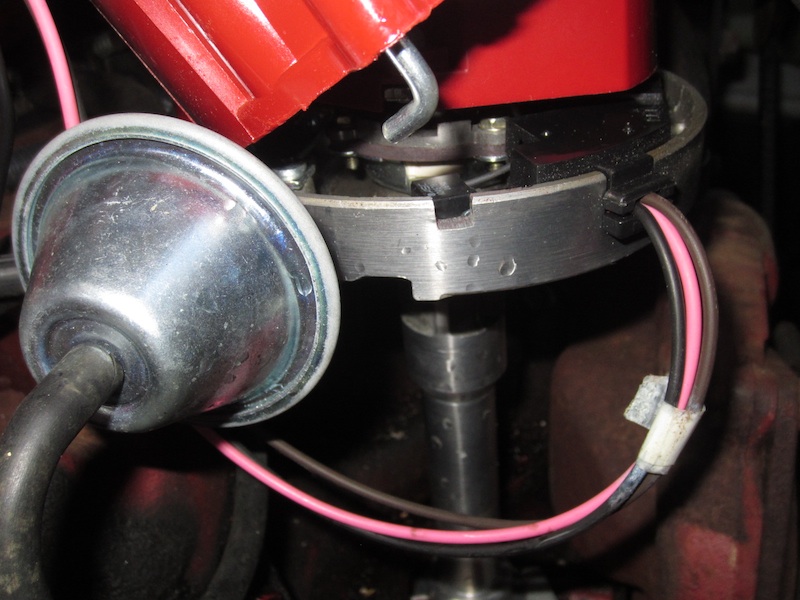

Brandonium, I installed the dui on my 392 engine a few years ago. I have a write-up in the dui thread over on bp from when I installed mine. A few items you need to be aware of:
1. The dui comes with a thermostat housing that has the extra bolt hole ground off smooth. Now is the time to replace the old t-stat & gaskets.
2. If the water temp probe is in the way, it can easily be relocated to the drivers side of the t-stat housing. It comes with a bushing & plug in the port on the driver side. Just use these to relocate the probe. The wiring for the probe is long enough to reach easily, just open up the wire loom and release the extra wire length.
3. I used a dremel to grind down the casting flash on the upper radiator hose outlet, along in inner curve area that will be near the distributor cap. Also, rotate the radiator hose clamp accordingly.
4. My dui cap electrical port & vacuum advance can were orientated approx. 180 degrees opposite. This makes it difficult to fit within the area available. I simply used the dremel again to cut a notch in the distributor housing so that the cap electrical connection was close to the vacuum canister, effectively rotating the cap 180*. I have heard some duis come with this orientated correctly, but it is easy to remedy. I elected not to cut the locating 'bump' out of the dizzy cap (plastic) as this 'bump' fits into the dizzy body to keep it properly located. Therefore I cut the new notch in the dizzy body.
5. Air cleaner: my truck has the factory stock air cleaner housing, no issues with that at all. It looks like your air cleaner has enough room and you should not have any issue there.
6. I made my own ignition cable holders with black tie-raps.
All in all a very easy installation and well worth the cost.
I've added a few photos of my installation.

IH, where was the optimal position that you used when stabbing your dui to ensure enough travel for timing? Just curious where your vacuum advance sits.
Here is a photo of my dui.
Small-dui - right side view copy
