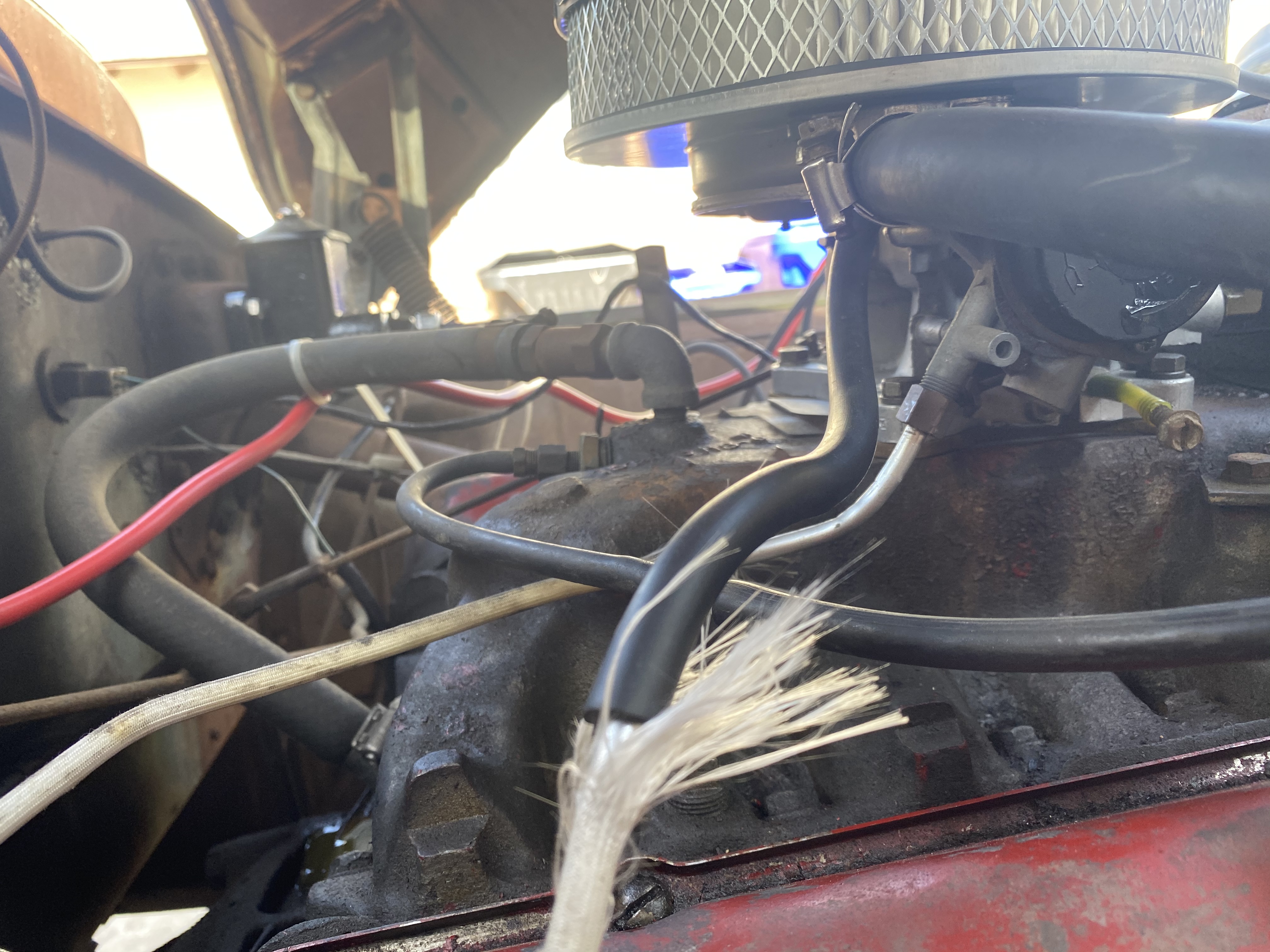

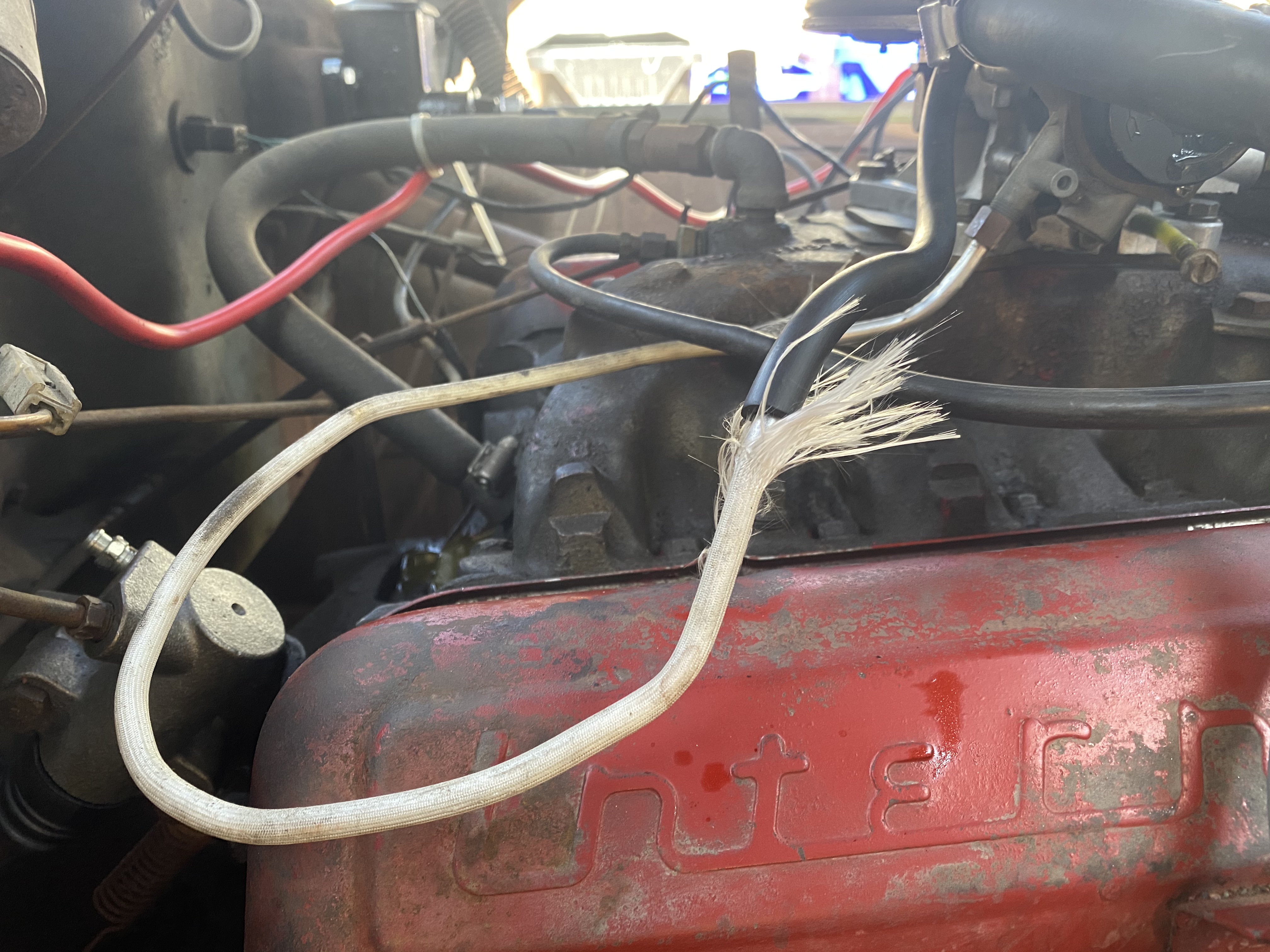

Hi everyone, I’m going to buy the dui distributor but I was just wondering what I needed to do/prepare for before buying it. I’ve attached a few pictures of what I’m working with. It’s a 1966 pickup with the 304. Also, I was wondering if everything was pretty much plumbed correctly. Another user has said that he thought the vacuum advance wasn’t going to the place it should be. Thanks all!!

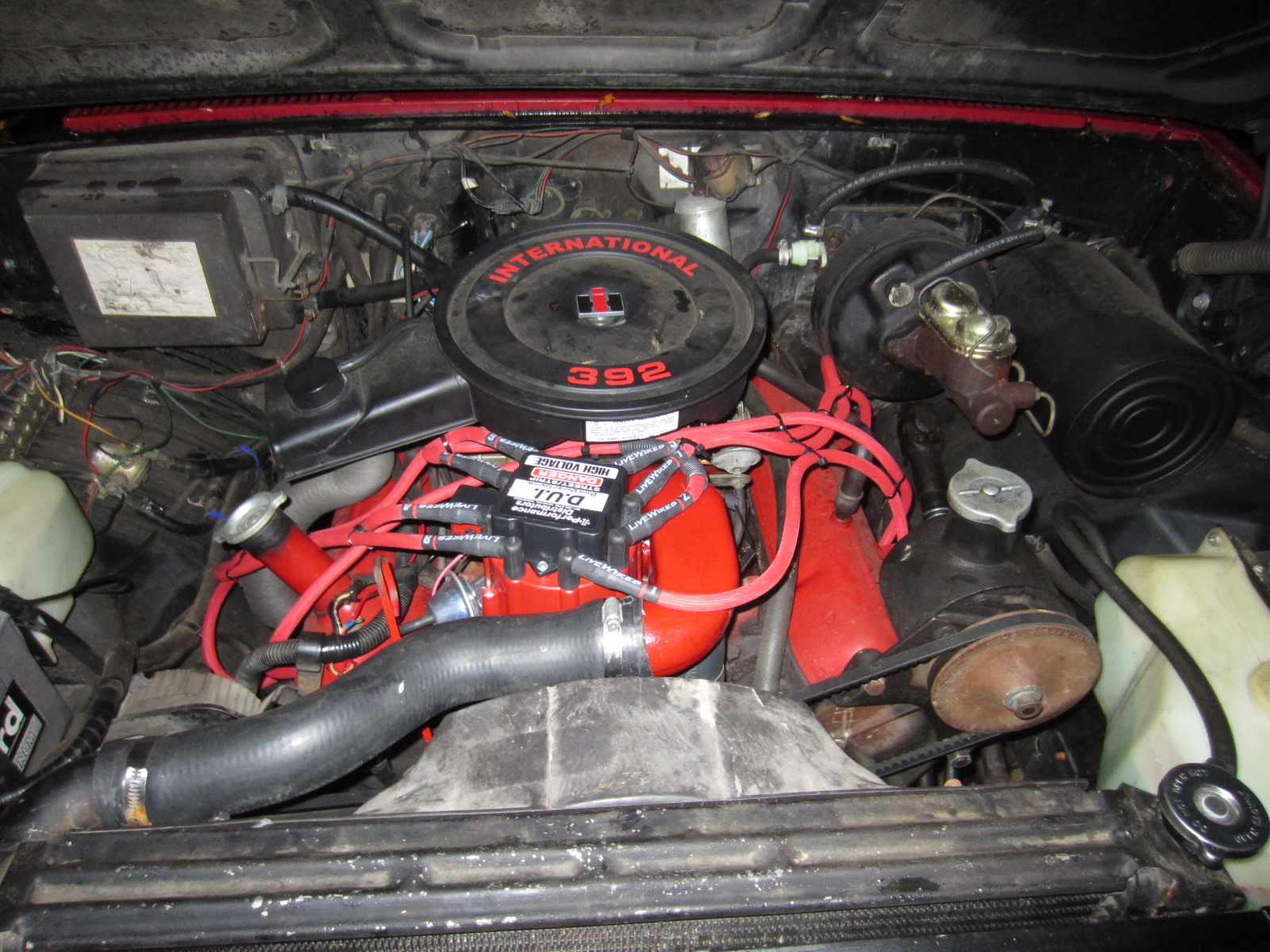

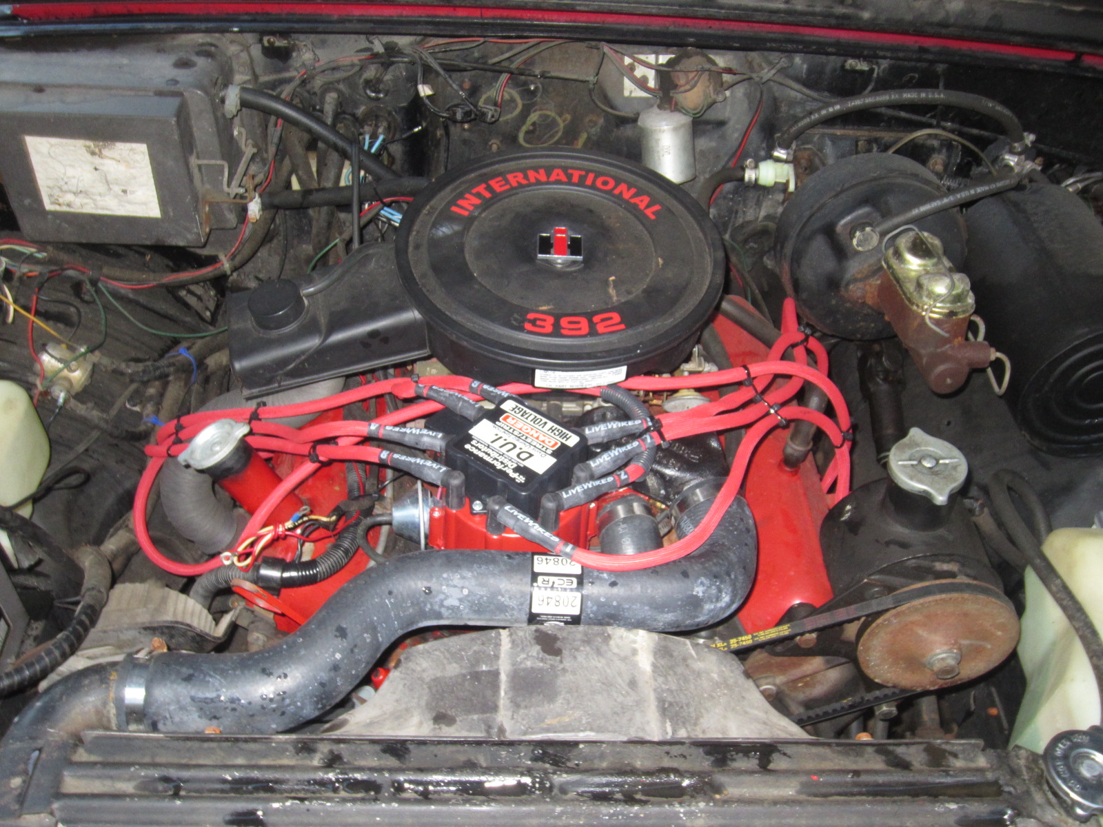

I would clean up the wiring, get that battery cable routed properly and perform a basic tuneup. You have the more desirable water neck on the thermostat housing that works well with the DUI. Will make a nice performance improvement when installed.
FYI, I have installed the DUI on my truck and it fits with the other two styles of water outlet housings easily.
See photos.
SV-8 392" with the 90° outlet. (above)
SV-8 392" with the offset outlet. (above)
Also, your vacuum advance question was previously answered on your Carb thread.
