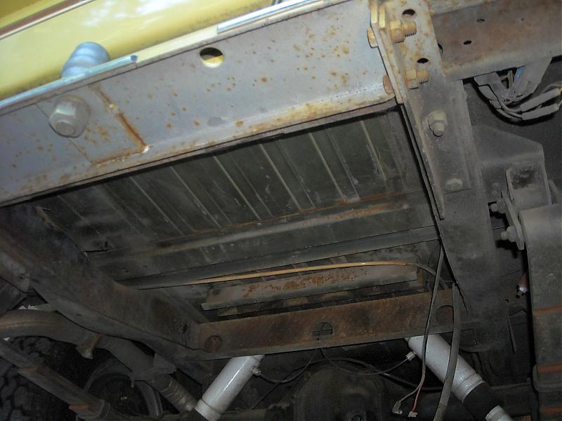

Pic is attached of a 100" wheelbase Scout II tank hole. The wheelbase onna traveler/terra is 118".

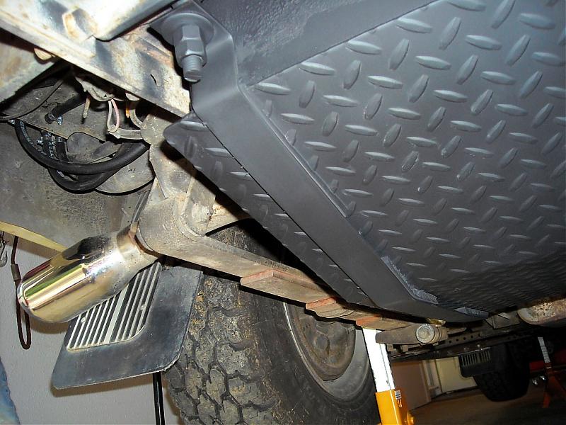

Here's a shot of the modded 33 gallon tank in it's new home. It's actually short now about two gallons since the bottom was removed , the sidewalls shortened, and a diamondplate bottom in heavier gauge material installed. The mounting straps are much beefier than any oem lashup.
