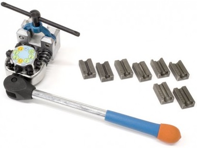

Quality tools huh? Here's what I use to flare my own brake lines and bleed my own brake by myself. The flaring tool gets clamped into a vise and literally takes all of 10 seconds to do the double flare for the brake lines. Best investment I ever spent. Paid for itself as soon as I got it. I got real tired wasting time and material trying to get any other flaring tool to work properly. Since I do 99% of my wrenching by my self, the motive brake bleeder makes my life easier to bleed the brakes when ever I feel the need. Not once have I had any issues with it.

quality tools huh? Here's what I use to flare my own brake lines and bleed my own brake by myself. The flaring tool gets clamped into a vise and literally takes all of 10 seconds to do the double flare for the brake lines. Best investment I ever spent. Paid for itself as soon as I got it. I got real tired wasting time and material trying to get any other flaring tool to work properly. Since I do 99% of my wrenching by my self, the motive brake bleeder makes my life easier to bleed the brakes when ever I feel the need. Not once have I had any issues with it.
More info on the brake flaring tool? Brand name?
more info on the brake flaring tool? Brand name?
It's an eastwood exclusive. The whole kit came in it's own plastic case when I got mine. Their description of the flaring tool, on their web site, is fairly detailed on what it can do. Little pricey, but for me it was well worth it. I got real tired of the crapzone tools that didn't work like they were supposed to.
Hi kimball. That flaring tool looks like a quality unit. For me with just the one Scout I like the premade brake lines. They also have a poly vinyl coating on them and they're black so they blend in with the rest of the mess. Tahoedonner; for that one line from the master cyl to the rear end if the fitting is leaking where it goes into the rubber hose I would also flare it there instead of trying to replace that line. Danny
Hey Danny. Thanks. It has come in extremely handy compared to what tahoedonner recently mentioned. I have had similar issues with those other types of flaring tools. And after going through at least 3 of them(tools) and countless flaring attempts with them, I purchased my eastwood flaring tool that made a pro flaring each time and so much easier and no wasted material.
