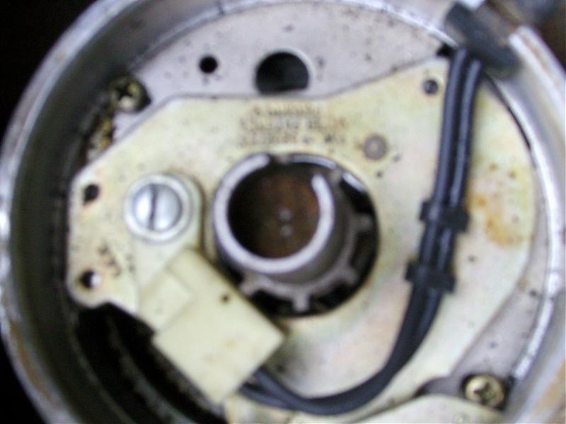

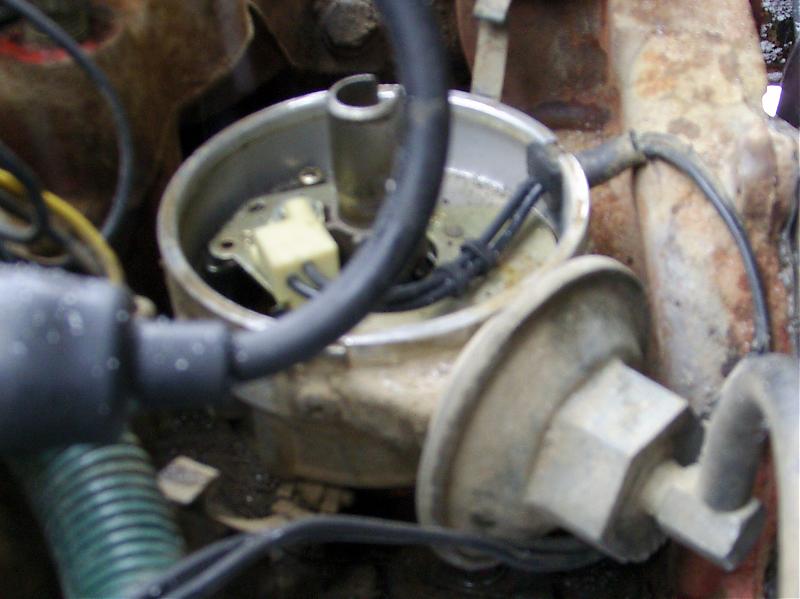

my question is did I guess correctly in identifing my dist? It kinda looks like the Holley gold box version. What kit can I use to upgrade the system to get rid of the gold/box/ make it perform better/ gas milage?

Yes, your pics show a Holley gold box distributor.
If it's properly functional now, there is no advantage to doing anything with it other than verifying that the advance system operates within spec. It's as "state-of-the-art" as any electronic-control, inductive ignition system currently available.
If the control unit (mounted to the firewall) has not failed in all these years, chances are very low that it ever will.
If it does fail, then the most cost-effective solution is to install a pertronix conversion in the existing distributor and do away with the control unit. A pertronix conversion for those distributors was introduced about five years ago. Pertronix p/n for that special unit is ho-181. Do not attempt to use a p-tron 1481, it will not work!

But if the mechanical advance and the vacuum advance are not functioning correctly, then that needs to be attended to before doing anything else. And...the end play needs to be checked, if it;s greater than 0.015" then the timing will vary considerably across the scale as the engine accelerates and then returns to idle in normal operation.
All the above has to do with "state-of-tune". Making certain that the distributor is up to snuff simply returns it's performance to oem when it was new. A tired distributor that is out-of-spec will certainly have an impact on fuel efficiency along with a tired carburetor.
