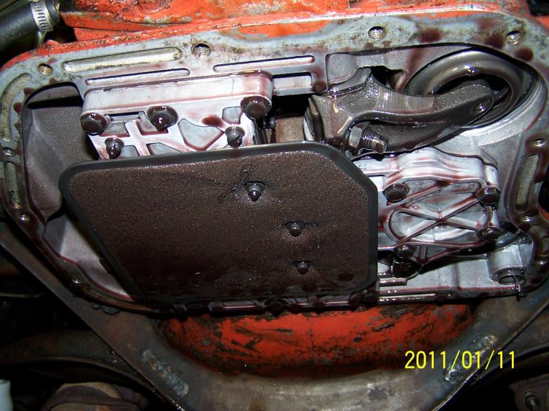

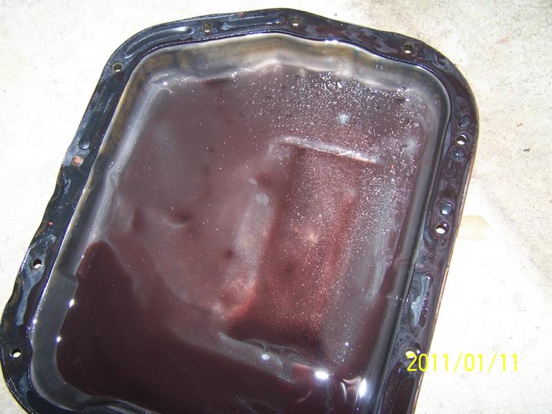

I was able to tighten the rear band up which took all slack out of the servo arm. I had about 1/2-3/4 inch travel in arm before made contact. Took about 6 turns of screw to remove slack. I tightend up more with a small 5/16 wrench to make sure the band would go tight without anything else comming loose. I then loosened back up to just to remove play in linkage. I dont own a inch torque wrench. Im going to remove the valve body and do a air pressure check of servo to make sure it moves properly. These are a couple pics I took after removing pan. Fluid was dark and not burnt. No broken parts. Had some medal shavings, no clutch material.

What I see in the pan is tons of metal along with fiber material.
With the 5/16" wrench, tighten the band screw as tight as you can get it with one hand. Then back it of 2.5 turns.
Then do the same with the front band screw that is on the outside of the case and back it off 2.0 turns.
Should then hold about 4 quarts (maybe 5) of new oil. Try it and see.
That fiber material you see is just fluid left in pan. It was mostly medal shavings. Anyhow..I saw in one of your topics about the part throttle downshift module on valve body. I know mine didnt have that on it. Is there any way I can set mine up to do that? Cant that module peice be added? Im going to do the tf-2 kit. Im more conserned about shifting and converter being able to get pumped up while in park.
