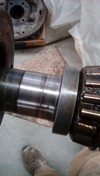

Is this a stress fracture or ? It is in a perfect line around the shaft.
O oktrader1958 New member Apr 19, 2018 #1 Is this a stress fracture or ? It is in a perfect line around the shaft. Attachments AXLE.jpg 28.1 KB · Views: 368
dkminors Member Apr 19, 2018 #2 If you use CRC Weld Check Penetrant on this it should help answer the question.
Robert Kenney Super Moderator Apr 21, 2018 #3 It’s very unlikely a crack would propagate from a smooth surface. 99% occur at a stress riser or corner. Magnetic particle inspection is the only true test for iron/steel.
