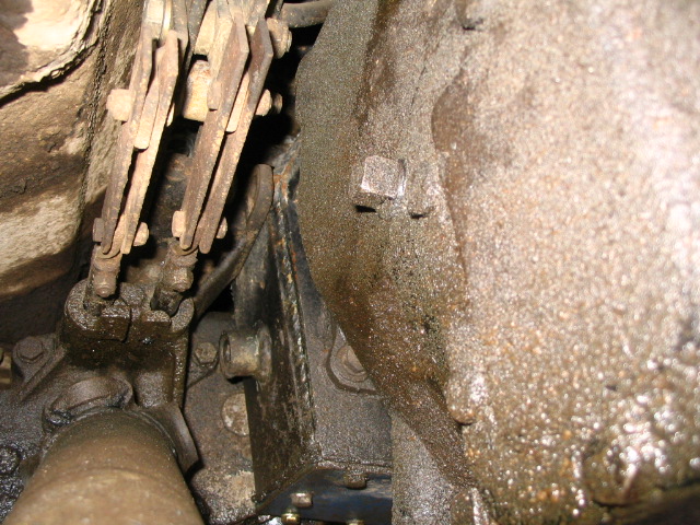

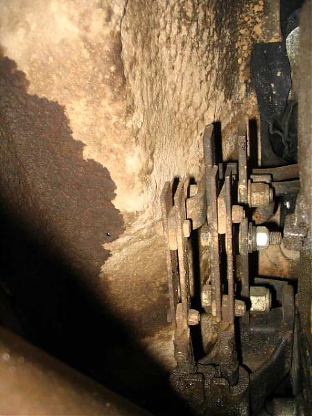

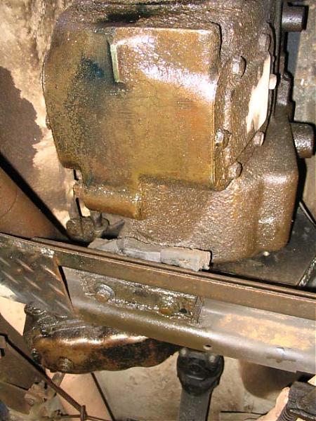

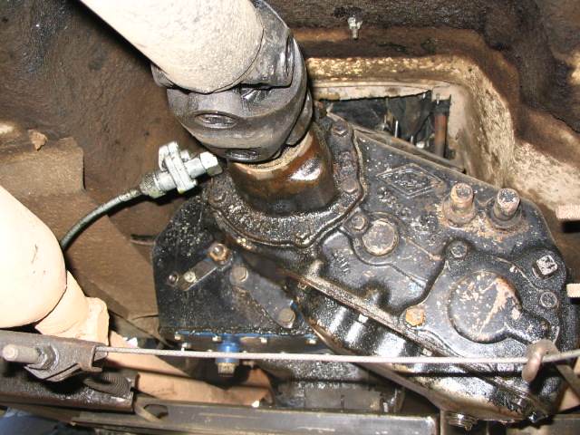

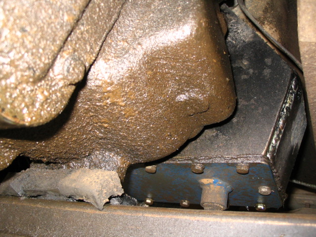

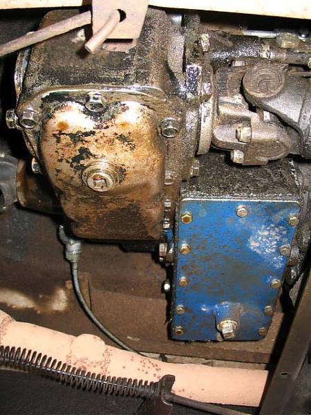

There aren't any real kits per say, but it has been done (called "cold duck"). D20s are just not the optimal front case.
If you have the length, you can do a d20 to divorced 205.
Put 3:1 in either case.
link 1
link 2
If you have a 727, your best bet would be to find an np203 off a dodge (get the 727 output too), and do a standard doubler to either a d300 or NP205.
