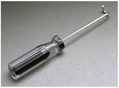

And speaking of tools, I've never found one that's worked very well, mainly due to the clearance issues at the #5 and #7 plugs (air-injections tubes and brake system being in the way). Has anyone ever tried this type on an IH engine? It looks like it might work. It's sold under the taylor brand at summit.

and speaking of tools, I've never found one that's worked very well, mainly due to the clearance issues at the #5 and #7 plugs (air-injections tubes and brake system being in the way). Has anyone ever tried this type on an IH engine? It looks like it might work. It's sold under the taylor brand at summit.
I started using that tool (or similar) on my IH a couple years ago.
But, I have a t/a and I think I May have a little more room to get to 5 / 7 even with the air.
Hmm. Thanks. Good to know that it can be slipped in there and hook the boot at least. Worse case scenario I could maybe put a bend in it so that it clears the master cylinder if necessary. Or cut down the handle. :icon_confused:

The spark plug boot remover you posted is the same ones I use in all my shop and travel tool sets, about $3 locally at any auto supply.
Awesome. Good to know. I'll look around for one. I doubt I'll find one for $3, but I'm sure it'll be less than summit is asking.
