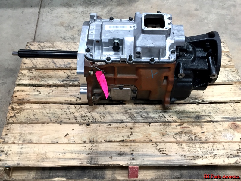

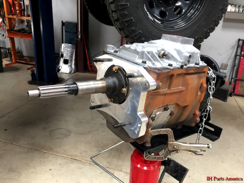

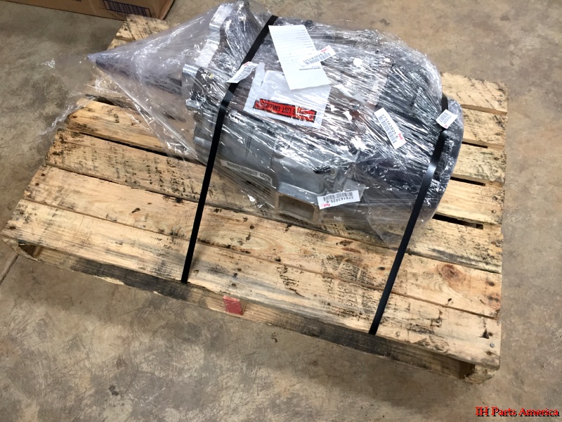

Pics below are of a new transmission that I just ordered two weeks ago and installed in my Travelall as my current transmission was worn out(it was used when I installed it).
attachment.php
attachment.php
attachment.php
In the pictures I have looked at on high gear's web site, I see that the tail housing on the two wheel drive units is very long, likely requiring the tc to be set back as much as a foot or more.
Fabing new drive shafts is not a problem, but there May be a problem with shaft angle to the rear axle.
I like the divorced tc. I also see that it might be possible to fabricate a coupling system to bolt my np201 to the 4wd nv4500. Lot of speculation, but I am also trying not to reinvent the wheel with this project.
