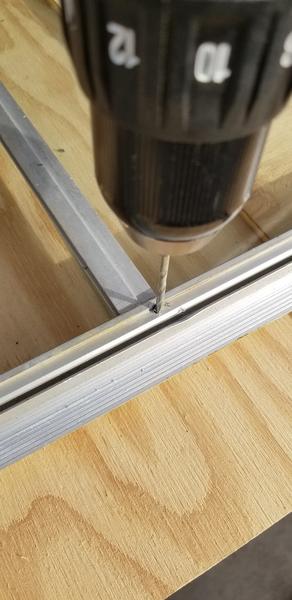

So I removed the 2 screws holding the joint together and I was not able to separate the frame and get the sliding window out. That's when it hit me I needed to remove the rivets holding the center piece in place. So I drilled those out with a 3/16" bit.

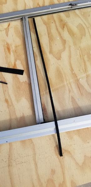

I needed to replace the thin piece of felt that goes in the vertical frame in between the 2 pieces of glass but had nothing of the sort. I remembered my wife has rolls of velcro, so I raided her sewing room and got a piece of the fuzzy side. I laid it on the workbench and cut it in a thin strip, basically just eyeballing it. I got some elephant snot (weatherstrip adhesive) and glued it in place. It looked perfect!!

Now I needed to install the sticky felt stuff that I was going to use for the slider channel. It's not easy getting it in the groove without sticking so we tried 2 tricks; first, we folded it in half lengthwise and slid it in the groove so it would go all the way in before sticking to the frame. then I also sprayed windex in the frame so the adhesive was slippery and would not stick until it dried. I tried some without the windex and found that was a mistake, so I went back to it for the rest of the job.
We used the piece of glass to push the felt into the groove and once it was smoothed out it looked great. I had to trim it in the area towards the middle of the window because you can't reach that part where the windows overlap. Once I got that done, I was able to get the window installed back in the scout and then finish trimming.
