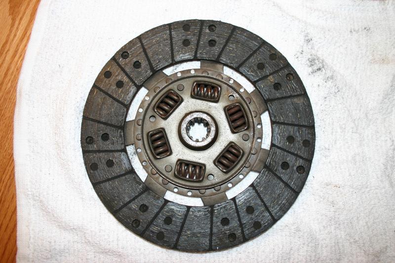

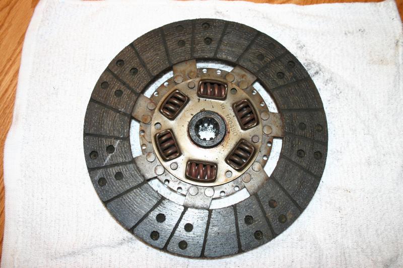

Depending on modle of clutch there is a minimum thickness. Usually so long as the grooves are still deep it will function. Proper pressure plate adjustment is important. Can you post pictures of the disk. Must be good quality to make out the friction media surface.

Thanks. Someone who knows what they are looking at might say it is junk. Or it might be ok, too. I just don't want to spend a bunch of money if it isn't necessary. I will only be driving my Scout around town occasionally. No rock crawling either.
I "inspected" the pressure plate. There does not seem to be any damage or any major wear. But, then again, I don't know what I'm looking for. I sure don't know how to adjust the levers.

Looks to have a lot of life remaining. The grooves runing radialy from inside to out side are deep and well defined. I'd run it if it were my rig.
Clean the splines and with some 150 sand paper rub the friction lining just enough to deglaze it. Do the same to the pressure plate face. This will help it seat in and have good grip.
When you bolt the disk and pressure plate to the flywheel prior to sticking the engine and trans back together, see that the levers are at the same height so the to bearing won't wobble and cause the clutch to shudder.
You should be good to go on a budget. Remember that there could still be issues with the pp that could cause undesirable results. Worth a try for $400.00. After all your labor if free. :yesnod:

First, which side of the clutch disk faces the flywheel. If you look at the pictures I posted, one side of the disk has the part number on it and the center part that the shaft goes through does not protrude out as far as it does on the other side.

Part number toward the flywheel. You need a clutch alignment tool to center up the disk with the flywheel while you install teh pressure plate...
