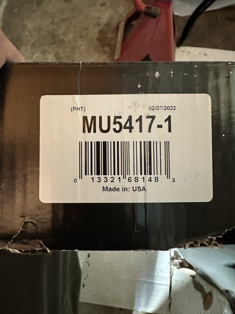

Does anyone know if a clutch from a T 34 transmission will work on a four-speed manual transmission? Does anyone have the part number? This is the clutch I was going to use in the T-34 but was wondering if I could use it in my 4speed manual? ( see picture)

Looks to be a 12" clutch. As long as your flywheel has the 12" bolt pattern then yes it should work on a 4 speed transmission. The alignment tool will be incorrect as a T34 uses a much larger pilot bearing than your 4 speed. If the kit came with a pilot bearing, it may not be the correct one for your 4 speed. We sell them on our online store if you end up needing one.
