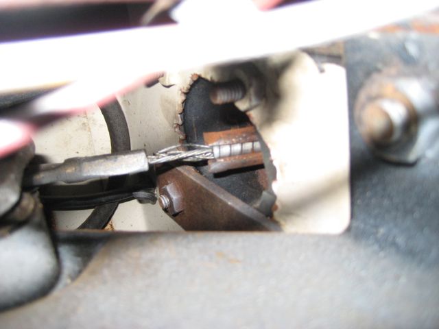

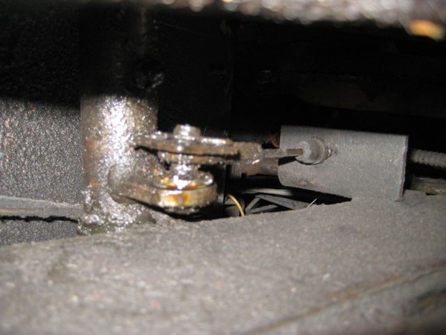

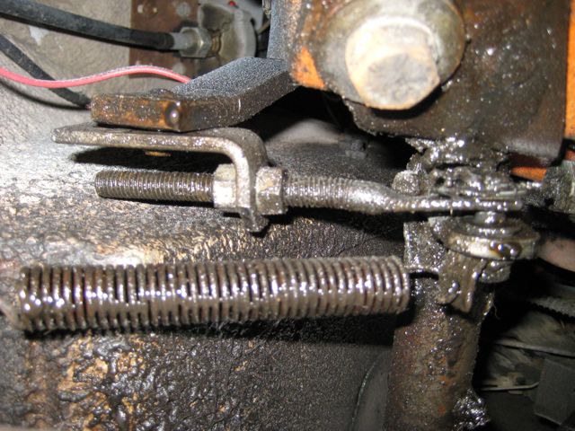

Here's what I found. Looks like maybe the cable is frayed and it looks like a b!@#$tch to replace...not to mention getting one in hawaii. How does it look to you?

That is the "other" clutch actuation system, the one that is shown in mt-123 parts list for 800a&b, I don't have a copy of that document.
Anyway, your cable is toast.
The light line p/n for that item is 434 797-c1. Call michael at the shop (ihon) and have him check stock on that item. Tell him you posted about this on the forum, he'll know what ya mean.

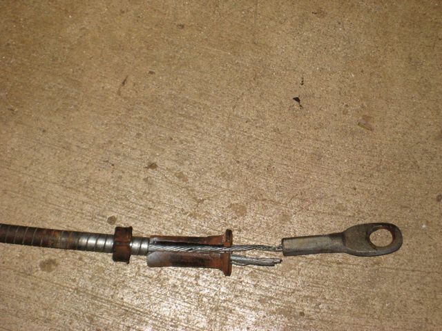

Attached is a photo of the shredded cable. Funny that before I sailed the Scout to hawaii I had to have Isa fab something to keep the cable together, you can see the remnants in the photo (wish I just had him replace it then). The funny part is that now that I'm sailing the Scout back to the mainland I had to call on Isa to save my clutch cable again. Much thanks to Isa filling my order fast.
Oh, and its amazing how well it shifts now...shocking.
