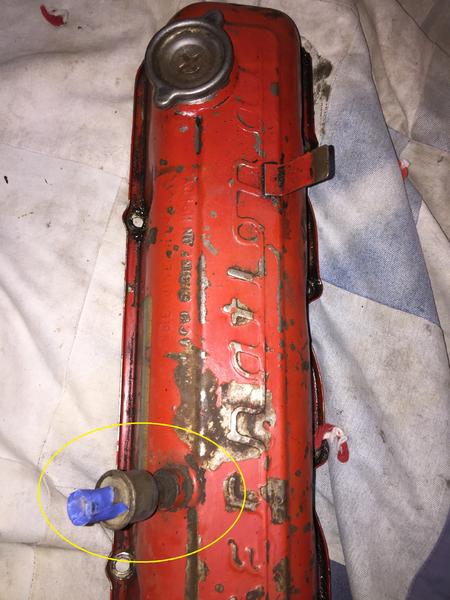

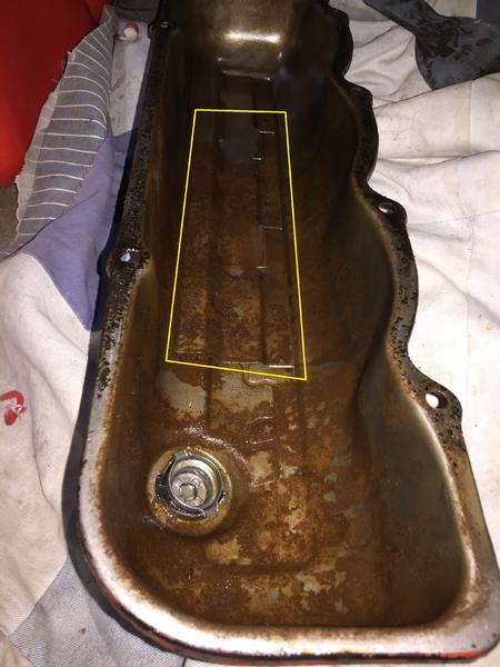

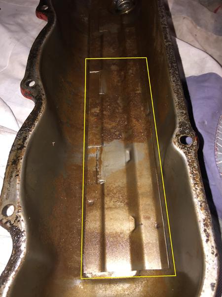

Well, I've got the valve cover off. Cleaned up the area before with the vacuum cleaning wand, and chased the top of the valve cover as I removed it. Worked great. I did see a little dirt fall in, but was able to suck it out with the vacuum. Now that I have it off, though, there is a lot of rust everywhere. I'm not going to touch the rust in and around the rocker arm assembly, as there's no good way to break it all loose and keep it out of the engine. For the valve cover, though, I'd like to clean it up. I was thinking about soaking it in some kind of rust remover or fine sandpaper/steel wool. Any recommendations? Also, I've included some pictures below. I'm not sure what the highlighted parts are. Is that the baffle or some fire suppression system? On the outside of the valve cover, the connector foes to a hose on the underside of the air cleaner. I don't want to get a bunch of rust under/in that and not be able to get it out. Thanks!

The highlighted piece is indeed the spark arrester. It routes to the air cleaner from the factory so you're good there. The rust on the valve cover can just be cleaned up with a wire brush.
Wire brush and remoil(remington gun care products) action cleaner degreaser would be my choise rinse but only because thats the only degreaser I have laying arround. Just make sure it evaporates with no residue and youre golden. Scrub untill its not rust colored anymore. If you wanted you could pull the rocker assy and clean it then torque back on. Would have to look up the torque spec.
Thanks a lot for the feedback. I’m a pretty big noob, so removing the rocker assembly scares me a little. Will have to think about that one a bit. Regarding the valve cover...So the shield on the top inside of the valve cover is also part of the spark arrester system and doesn’t have a bunch of passages where rust will accumulate if I just rinse it really well? I thought I saw another post that said I could also remove the arrester and soak it in solvent/blow it out to clean it. There is just a wire “mesh” or “confetti “ inside it? Lastly, this valve cover is on the passenger side but I keep seeing posts saying the spark arrester is supposed to be on the drivers side. I’m wondering if a previous owner swapped the valve covers because the oil fill is easier to get to on the passenger side. Does it matter as far as engine function if it is swapped? Thanks again!
Lots of people did the switch to make the oil fill easier to get to. When I just put my 345 back together I did this.
