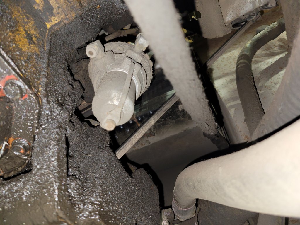

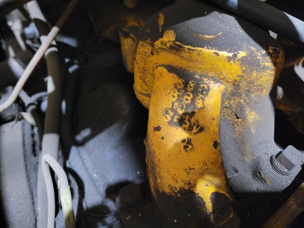

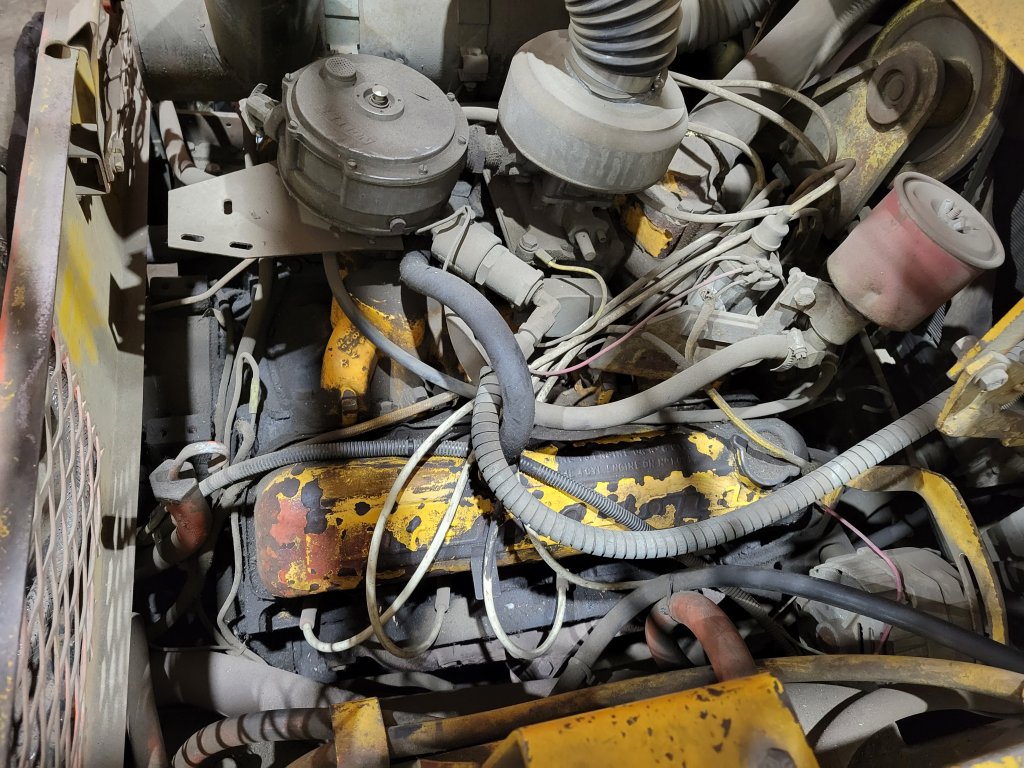

Im currently working on a older cat t200 forklift that is powered by a ih v8 that runs on lp. Any advice would be welcome to id the cid so i can find rebuild parts. The cat manual doesn't state what size the motor is.
I doubt im going to get the boss by the fuel pump too many components in the way. I also barely fit under it.

It is an SV series engine. So either a 266, 304, 345 or 392. The 2 barrel carb likely removes the 392 from the possibilities. Parts are generally the same across this series, except for intake manifold gaskets.
