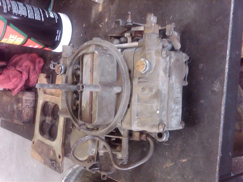

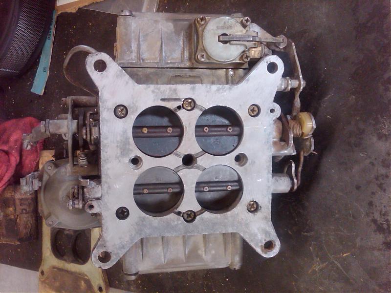

Apparently, the carb that I have May require a jet change as you have indicated. The list no on the carb is 1850-1. Right below is 0357. I had this one rebuilt by an old timer at advance auto (who does this rebuild stuff on the side).
The manifold has a number stamped on it 151539.
Today, we smoke-tested through the pcv valve in the valve cover and found no vacuum leaks. Looking down into the carb when idling and then accelerating, there is a steady stream of raw gas, which indicates to me that the accelerator pump is working. But, open the choke for more air and it just stops running.
The timing is set at 20 degrees adv, at 400 rpm, warm. The vacuum advance is worn out and needs to be replaced.
Perhaps the jets need to be replaced.
