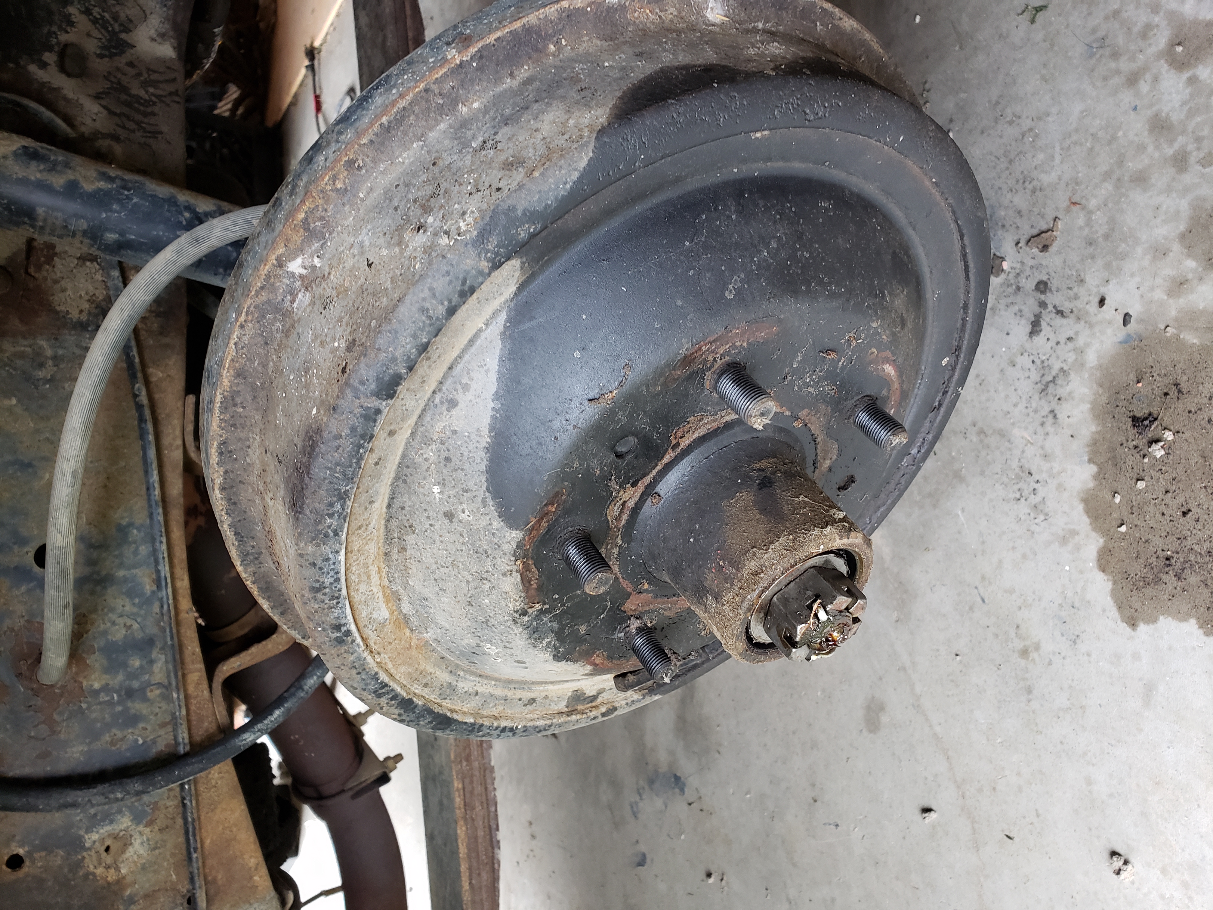

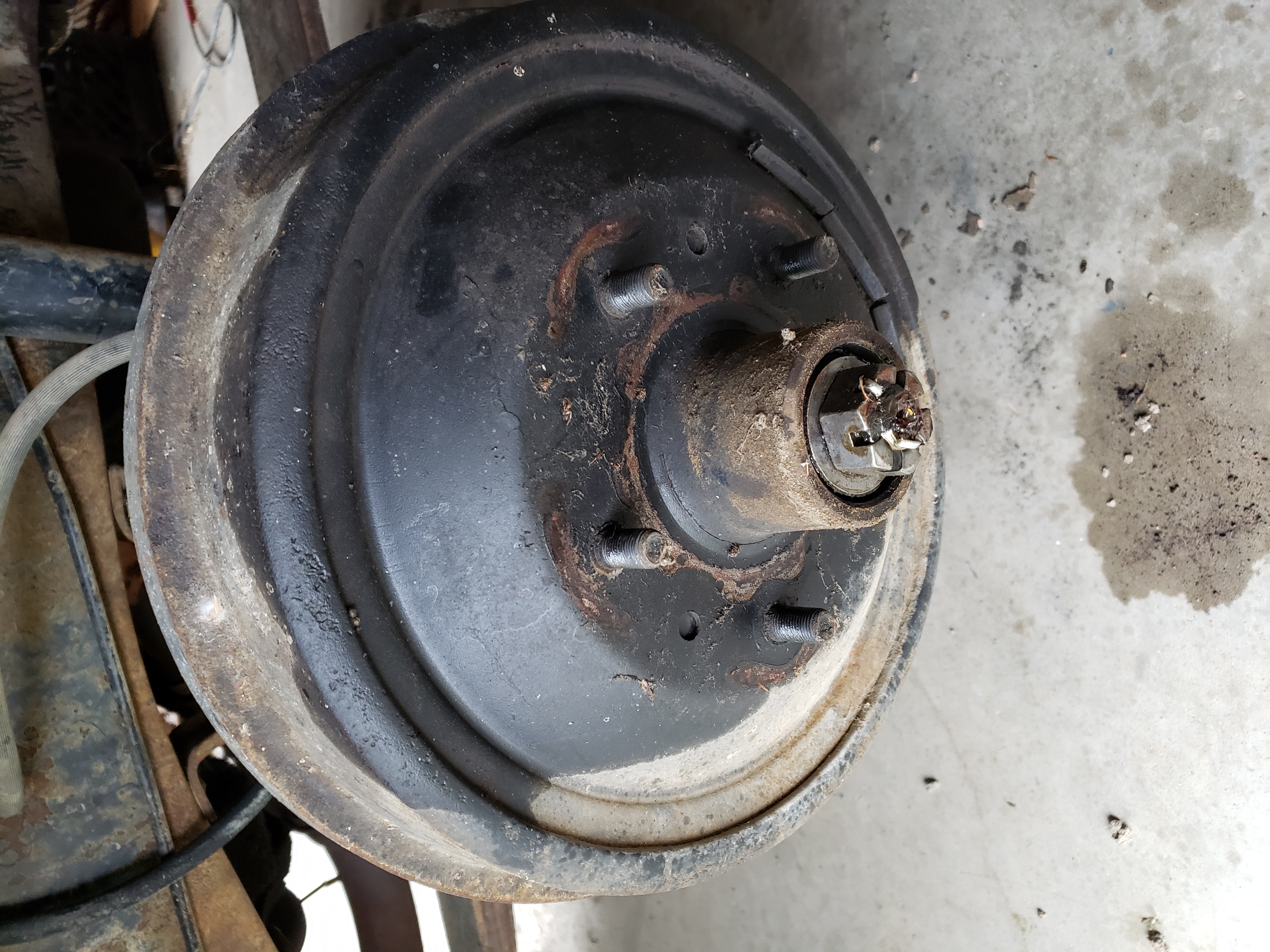

A Android2887 New member Jun 7, 2020 #1 68 1100c . For the life of me I can not get the front drums off.... do I need a special tool or something? Attachments 20200607_193737.jpg 4 MB · Views: 418 20200607_193726.jpg 4.1 MB · Views: 442
1975IH200 Active member Jun 7, 2020 #2 Remove the cotter pin, nut and washer. Should then pull off if you back-off the brake shoes via the adjusters.
