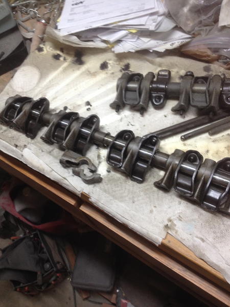

Rebuilding a 1975 345 and just cracked one of the rocker stands (9 stand assembly). Looking to replace asap, can anybody help?
I think it was the fourth from the back on passenger side.
Will post pics in the am with the part number. Can I replace just the one, if I can find it?

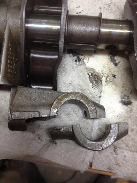

Pics included.
Part #
151181 r1
1107-9

Theoretically they are all the same except for the oiler stand. It sits over the oil port in the head and has a hole in it that lines up. Simply compare the shaft hole to the bottom dimension. Some rebuilders grind the bottoms.

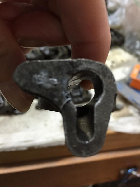

New pic, bottom of broken rocker stand.
The little notch means that it is an oil passage, correct?
I mis-spoke earlier, the broken stand is # 5 (center) from passenger side.
