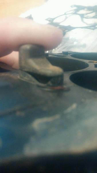

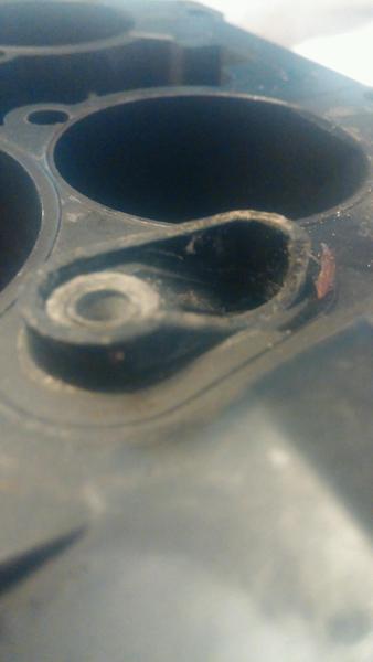

Finally found sometime to get over to the Scout and take a few pictures
the carb is a 9128s
I am familiar with glueing back on the fuel wells this site has been veryhelpful for carb rebuildng and other diy repairs.
