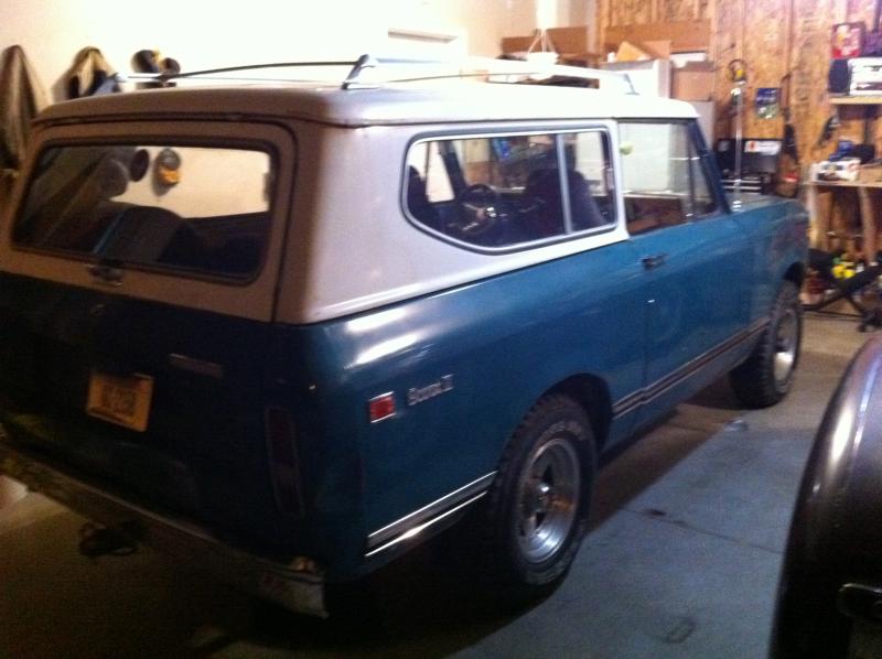

Well, I have pressure at each brake, though the front bleeders just dribble, I'm wondering if that's a pressure issue or if the bleeders are clogged/rusted up. I only assumed it's the proper proportioning valve, but it doesn't have any extended nipple to depress anywhere, and doesn't look exactly like this.. brake proportioning valve for power brakes - International Scout parts. Think I might just end up putting a generic valve in and adjusting from there. The thing does stop pretty well if I give it two quick pumps, but if it's just the first brake application it pretty much sinks almost to the stops and then feels like old style manual brakes (secondary system?). Thanks michael.
