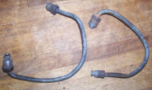

For doing a bench bleed of the master cylinder, I use a couple of short pieces of hard line with the proper fittings and flare to be screwed into the master. Then route the opened end back up into the reservoirs. For me, it's easier to mount the master cylinder onto the booster and use the brake pedal. Filling up both reservoirs with fluid and pump the brake pedal to cycle the fluid through the master. I thought I had a spare master cylinder laying around, but here's a snap shot of the short pieces of hard line/fittings I use.

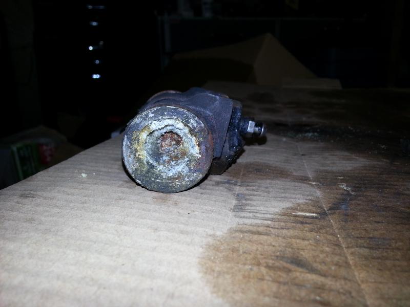

Solved. Finally bled the system enough to get all of the air out and fixed small leaks at the front caliper attachment.
Rear brakes fixed by replacing the slave cylinders (only $10 each).
The picture shows what the old ones looked like. Yes, I dumped sand out of them.
