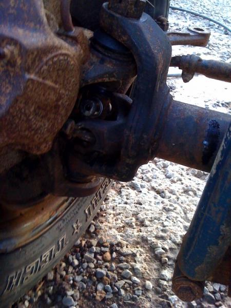

Look what I've found? I was steam cleaning and low and behold there it was! I think the source of the boooom! Picture is kind of hard to see but you can see the u-joint sticking out and the the hole in it goes into is busted. Now I guess I get to learn how to replace the drivrers side front axle shaft. Are there any thread showing the proceeder on this this?

It is not as bad as it sounds
just take off the brake caliper and zip tie it up out of the way
remove the locking hub
remove the spindle nuts
slide off rotor
remove the next set of spindle nuts, slide it off with the backing plate
pull old axle out through the knuckle, then put a new one in.
