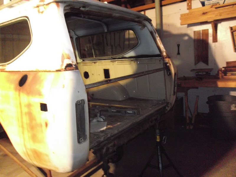

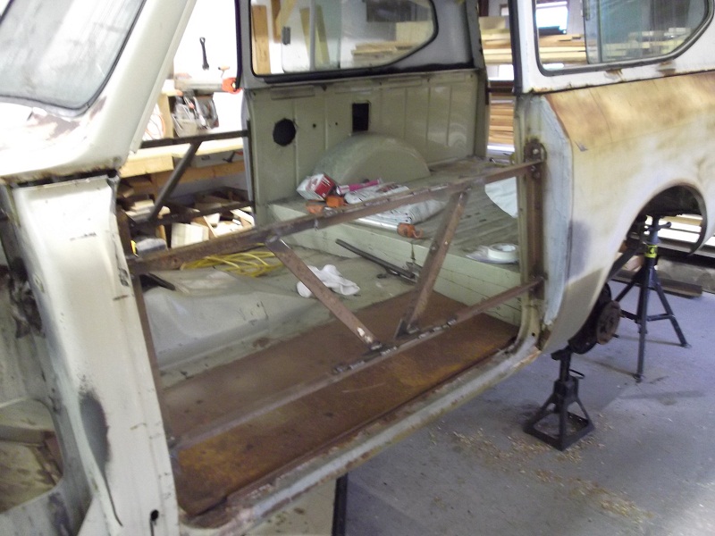

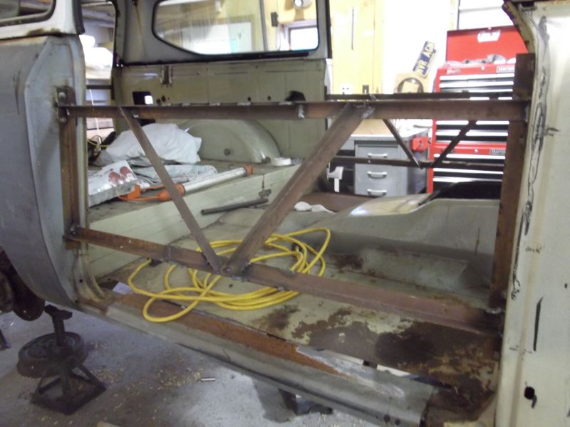

I'm finally ready to remove the tub from the frame this weekend. I know the importance of bracing the openings for stability. I plan on bolting angle vertically in the door hinge bolt holes and lock strike bolt holes then welding more angle horizontally between to connect them. Likewise with the tail and lift gate openings. Anybody done it this way??? Pro's & con's???
Heres what I did. What say ye now?????
