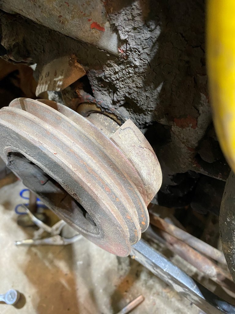

I am wanting to purchase a full set of pulleys (i.e. crank, water pump, p/s pump, a/c, and dual on alternator). My question is, how can I tell if I have a dampener or crank hub. I'm not having any luck finding pictures to go by. Any help will be appreciated. I don't want to buy the wrong set.
And for what it's worth, even if my current pulleys don't follow what I wrote above. That's the end goal.
Is the engine staying in the Travelall, or are you putting it into a Scout? Need to know so we can recommend the correct pulley kit.
It is going into (has been) in my Scout II. Thanks for your help on this.
There is no air injection pump, if that makes a difference..
Couple more questions. Are you using the Scout II power steering pump? Do you have air conditioning?
I will be using the Scout II power steering pump and will have air conditioning. And I'll also be using an alternator with a dual pulley.
