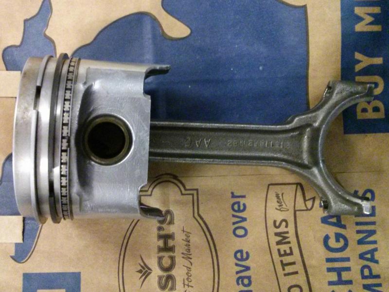

I seem to have bent the skirts on several of the pistons from the IH 345 I am rebuilding. Apparently happened from the piston flopping around on the rod while cleaning them up.
Anyone encountered this before? Is this repairable?

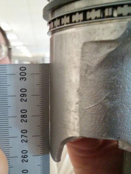

When I put a straight edge on the piston, there is a sliver of light under it.
Worst piston is about .009 too wide at the bottom of the skirt, interference fit in the bore. Pistons are .040 over. Measure 3.912 just above skirt and 3.919 at bottom of skirt.

Pictures of the piston attached. Gap to straight edge is visible in the picture.
