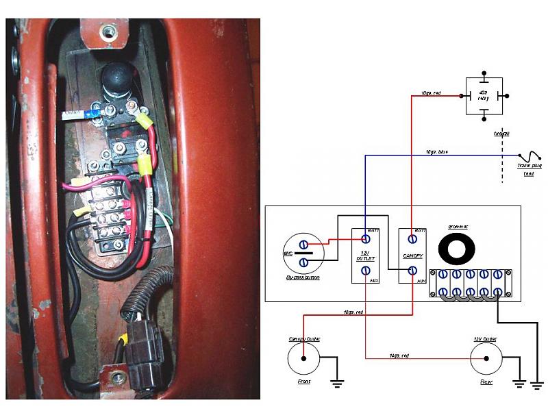

None of the die hards came into the plant today. Gave me some daylight for photos. :icon_lol: a little wiring left to do but it’s now functional. :icon_up:
not all the wiring was in on my sub-panel when I took the pic. I still need to tie in the supply wire from the key fob circuit. Now I expect everyone to keep the location of the secret by-pass button :icon_biggrin: "remember I know where you live" actually come to think of it I don't................remember you don't know where I live". :icon_wink:
took advantage of an existing 10ga. Circuit that ran to the trailer plug for the by-pass feed and added a 12v outlet to the rear of the bed.
Had to look far and wide to locate some 10ga wire in a jacketed pair. Glad I did as it tied in to the l shaped wiring bracket much cleaner than if I had used split loom.
