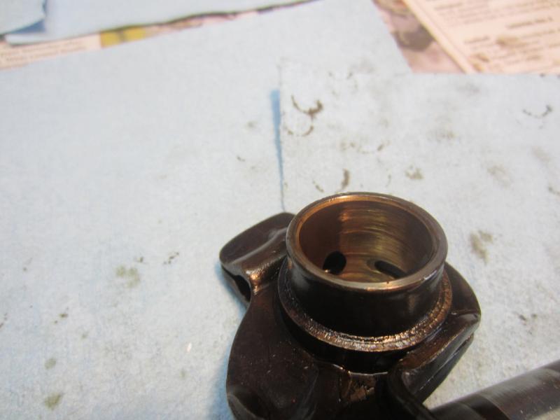

Frustrated! When I drove the truck a couple miles the knock came back. Same thing, the valve doesn't move, but the push rod and rocker do.
When I cold start the engine and check the valve movement the valve moves, but I determined that it does not move as much as the adjacent valves. So it seems that I have some valve movement with a cold/warm engine and then no movement when the engine gets fully hot. I didn't verify again with a compression test, but I am confident that the valve is fully closed and believe that the problem is downstream from the push rod - either the lifter or the cam. Also, the push rod doesn't rotate as fast as the others.
What to do? I need to verify the problem before I can move on.
Winter is here, expecting 3-5 inches of white stuff tomorrow, plus I lost the clutch on my 800, so now I have two down internationals.
Not many potential causes at this point in the game.

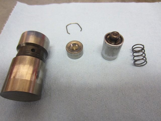

1) a lack of sufficient oil flow to the lifters, fed by the rear cam bearing..
Fix: engine comes out and cam comes out and bearings are installed. Along with a new cam and lifters. Based on your lifter photo of course.
2) flat lobe and lifter worn short so the oil feed port does not line up with the lifter.
I really can't see any other cause. Possible the oil filter is passing metal which is getting into the lifter. I doubt it though as the passage into the lifter is so small. Sorry. :nonod:
Yeah, it looks like I'm sol with this motor. No way I can jump into that project with winter coming on. I thought I would try one more shot in dark and add some extra oil and run it one more time before parking it in the way back for the winter. Should do a compression check to evaluate the pistons and rings.
Have to evaluate the cost/benefit. I got the truck for free and probably have maybe $3k in it - windshield, tires and rims (that could go on my Scout), bumper, fuel system, springs and shocks, a crate of spray paint. Need to figure the cost of a new cam, bearings, lifters. Maybe new rocker shaft, and add in some extra for all the other fix-its that will need to be done along the way. I have never rebuilt a four stroke engine, so there will be a lotta' learnin' along the way.

Just want to report the final diagnosis after engine tear down.
Bad lobe on #7 exhaust cam, #4 and #1 cam bearings toast. #2 showing some wear.
