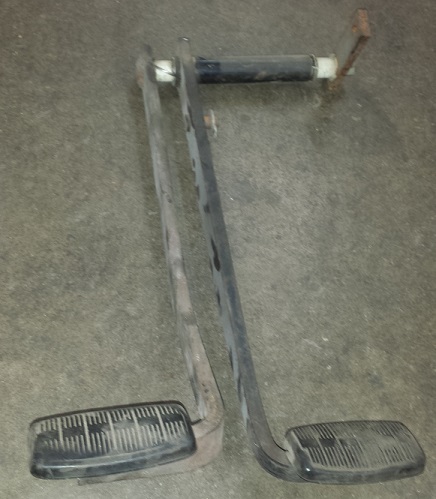

As I was scrounging around in my cave looking for something else, I came across this clutch and brake pedal assembly sitting on the shelf. Wasn't exactly easy to pull out due to being in a cramped space and how the clutch pedal is welded to the shaft.
