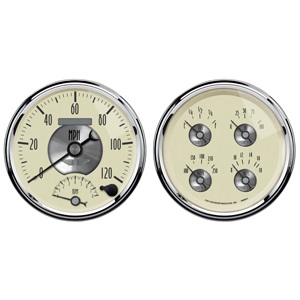

Hey people. Just wanted to bounce this off u guys befor I spend alot of cash.....
Are thies the correct for my application....
Im in a 1962 Scout 80.
auto meter
And will the fuel sending unit fit I believe it comes with the kit.... Would be sweet.
Thanks
rob

You would need to find out the specifications on the fuel gauge. There is an ohm reading that matches between the the sending unit and the gauge in order for it to read correctly from empty to full.
Off the top of my head I don't recall what the ohm reading is for the stock sending unit. It's posted some where in the forum. I'm aware that isspro fuel gauges will match up with oem sending units in the Scout II's. Auto meter does have different models of each series of gauges, to choose from, that have different ohm readings to match up with the different sending units
That's a sweet gauge set up! You need to find out what ohms the autometer gauge is designed for. Scout fuel senders are designed for 10/72 +/-10ohms. I would recommend buying the matching temp and oil pressure sending units from autometer as well so that you know everything is matched up. And of course your gauges are only going to be as accurate as your wiring will allow them to be so if you're running around on old, original wiring you May want to update that as well.
that's a sweet gauge set up! You need to find out what ohms the autometer gauge is designed for. Scout fuel senders are designed for 10/72 +/-10ohms. I would recommend buying the matching temp and oil pressure sending units from autometer as well so that you know everything is matched up. And of course your gauges are only going to be as accurate as your wiring will allow them to be so if you're running around on old, original wiring you May want to update that as well.
I agree we rewired the truck and it should be ready to handle it thanks alot for all the great feed back . I cant wait to get that set up will be sharp. Looks like its gonna hve to wait. Radator blew o. The neon lol. The tans cooler line bused going 55 was a show......ah wants and needs
